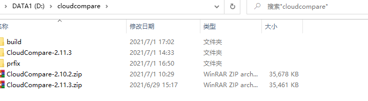

1. Create a folder in the d drive as shown in the figure

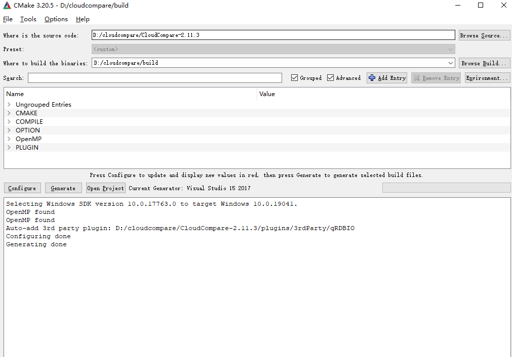

2. Select this in cmake
Click on configure and generate

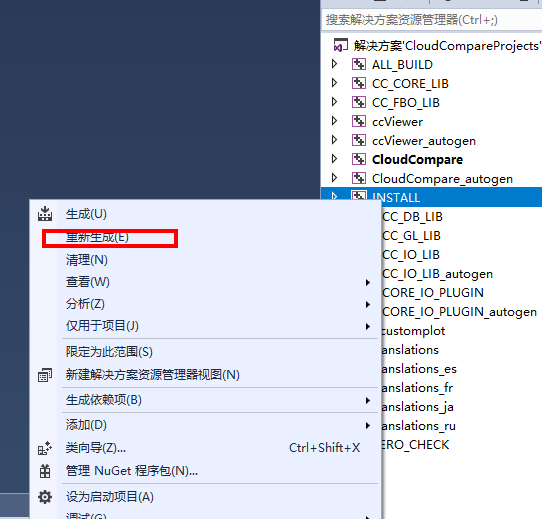

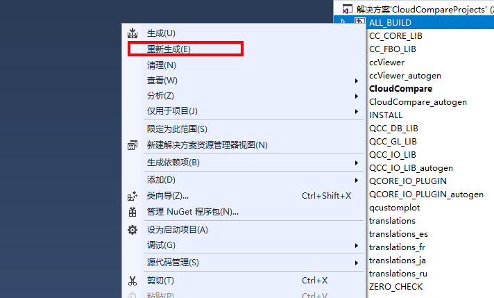

3. Find the sln file in the build folder and open it with vs2017
Right click all_build and click regenerate
Right-click ALL_BUILD, click Regenerate

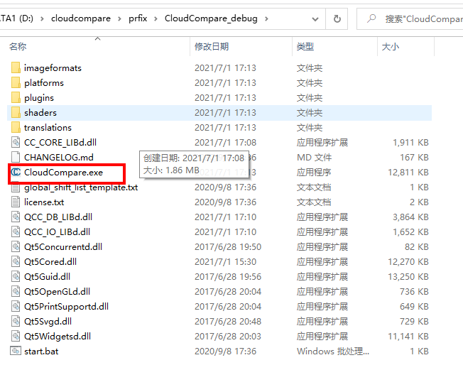

4. I get this in the file
Double-click to open and display

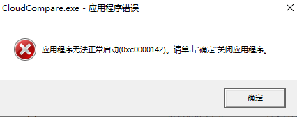

In windows event viewer, it shows this.
can you help me
