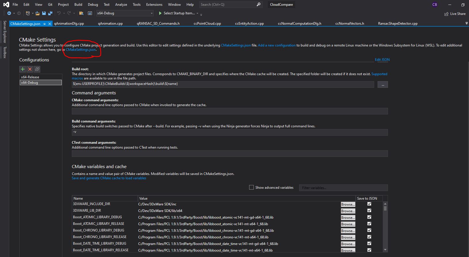

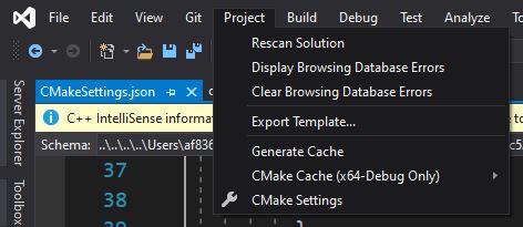

I would suggest using visual studio 2019 CMAKE, just right click on the folder C:/Users/bierlaire/Desktop/CloudCompare and select "Open with Visual Studio".
then set your CMAKE settings from the project menu

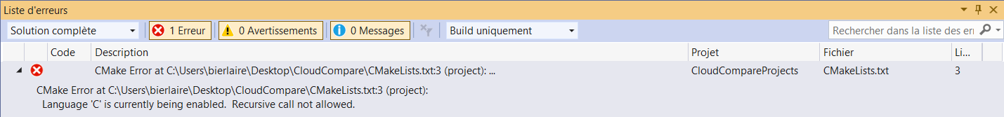

Now trying to right click and open the folder, I get this issue :
I have tried to look at CMakeLists.txt, but I have no clue on what should fix this error.
Do you have any idea ?

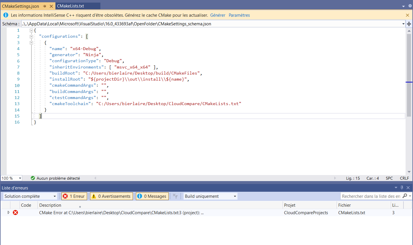

To give me a better idea of how you have it set up, please attach the CMakeSettings.json file that VS2019 created.
go to the CMake Settings like before and then select CMakeSettings.json
jbierlaire
Joined: Thu May 20, 2021 11:49 am
Re: Issue with CMake
Post by jbierlaire »
Here is my CMakeSettings.json :
  "configurations": [
      "name": "x64-Debug",
      "generator": "Ninja",
      "configurationType": "Debug",
      "inheritEnvironments": [ "msvc_x64_x64" ],
      "buildRoot": "C:/Users/bierlaire/Desktop/build/CMakeFiles",
      "installRoot": "${projectDir}\\out\\install\\${name}",
      "cmakeCommandArgs": "",
      "buildCommandArgs": "",
      "ctestCommandArgs": "",
      "cmakeToolchain": "C:/Users/bierlaire/Desktop/CloudCompare/CMakeLists.txt"
WargodHernandez
Posts: 187
Post by WargodHernandez »
I would remove this line
The CloudCompare CMakeLists is not a tool chain.
