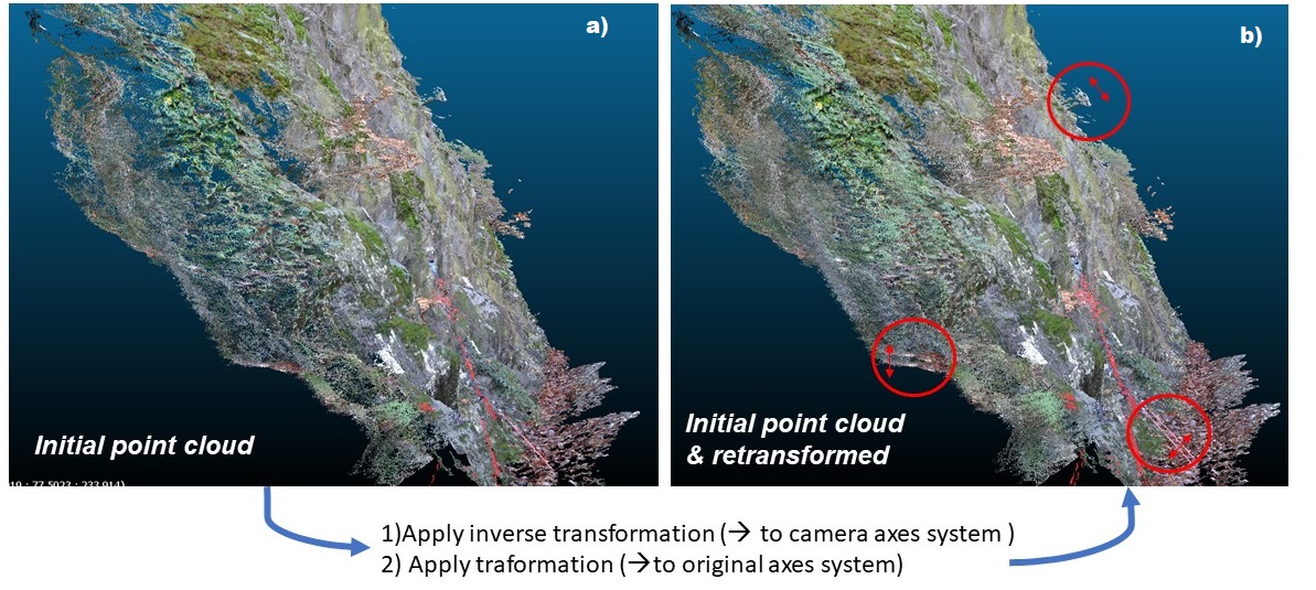

I have a point cloud (axes x,y,z, origin o) that I need to transform according to camera axes orientation (let's say x',y',z', camera center c to be used as origin). To do this I've calculated the 4x4 matrix necessary to apply the rotation and translation of my system, and I've used it in the "apply tansformation tool".
The result seems good, but when I retransform it back to the original axes (unflag the "apply inverse transformation", figure b) the outcome doesn't completely match the original point cloud (figure a,b).
Presentazione standard1.jpg (256.6 KiB) Viewed 17418 times
Why does this happen?

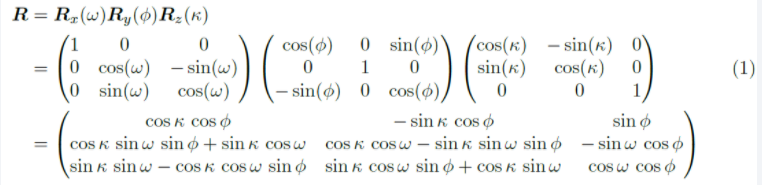

Thanks for reply, I use the camera angles orientation (omega, phi ,kappa) to calculate the rotation matrix using the equations as :
So i think that each vector (= 3 first columns) mathematically is equal to 1, and they should all be orthogonal to each other (X.Y = X.Z = Y.Z = 0). Am i wrong?
