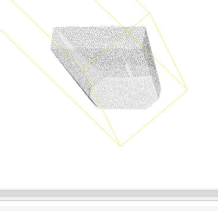

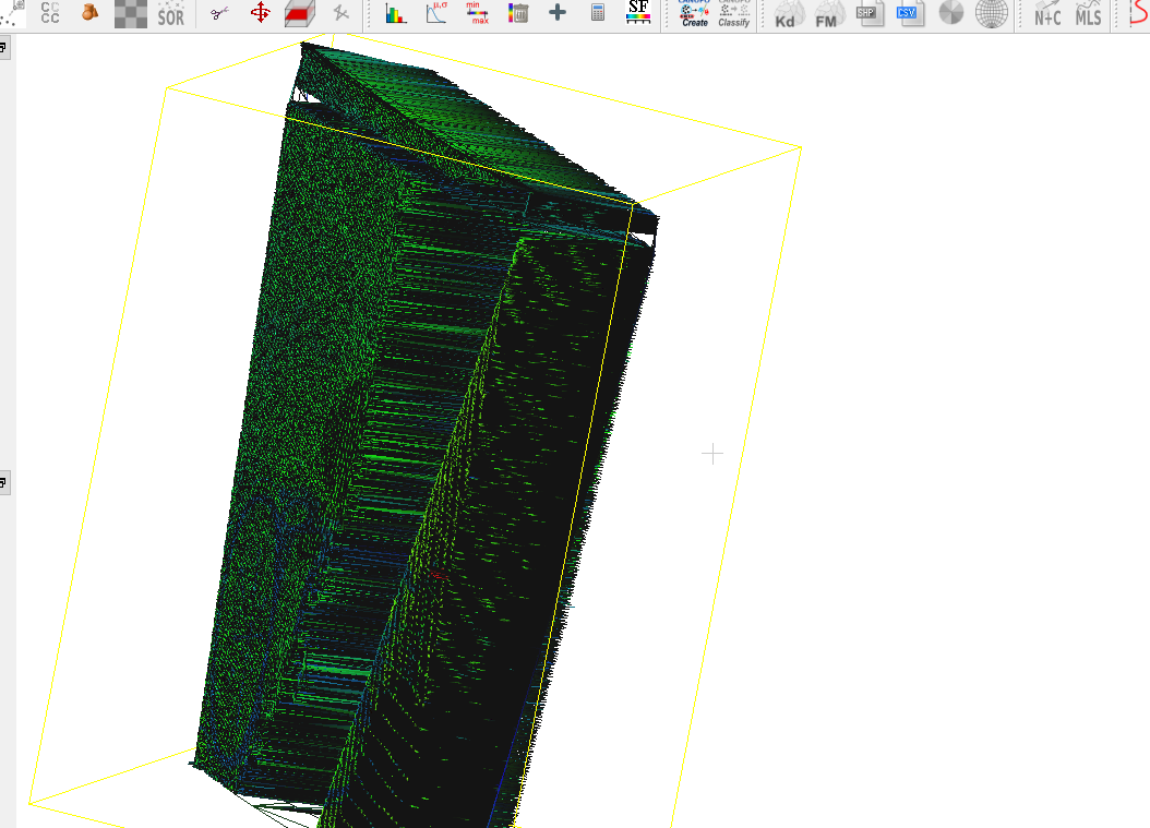

Buenos días al realizar el mallado de la figura adjunta, no lo realiza bien y no entiendo el motivo. Para mallarlo primero compute sus normales y luego malle con best fiting plane. He probado a invertir las normales, reducir el numero de puntos de la nube, aumentar el numero de vecinos sobre los que pivotar a la hora de calcular la normal, pero nada da resultado. Podría ayudarme alguien. Muchas gracias.

OK I speak english i traslate: Good morning when I mesh the attached figure, i do not do it well and I do not understand the reason. To mesh it first compute the normals and then mesh with best fiting plane. I have tried to invert the normals, reduce the number of points in the cloud, increase the number of neighbors on which to pivot when calculating the normal, but nothing works. Could someone help me. Thanks a lot.
Re: Mallado Incorrecto de una sección
This looks like a 3D shape. You can't use the 2.5D triangulation tool.
You should consider using the Poisson Reconstruction plugin (but you'll need clean normals - see the 'Edit > Normals > Compute' method and the documentation for both tools on CloudCompare's wiki: https://www.cloudcompare.org/doc/wiki)
