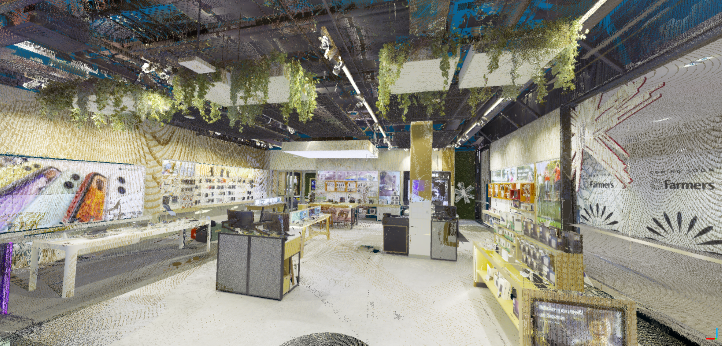

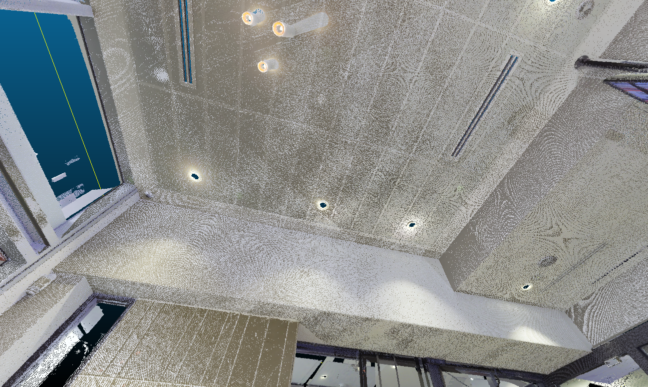

We have been scanning with a RTC 360 and noticed due to slight variations in lighting/ exposure dependent on scan positions, it will create a "patchy" surface as the different scans are overlaid on top of each other please see attached images below.
I have tried decimating the points by space to reduce overlaps but in that case, it is still far from perfect and also lose detail which is undesirable. I have tried to experiment with a method in which two overlapping scans are compared with one being reference and the other(s) being compared and any points from the compared scans overlap with the referenced scans, they can be classified and thus removed. I was wondering if this methodology is appropriate to solve this issue and how to accomplish this.
Appreciate any help on this :)
p.s I understand that scanning in more controlled and optimal conditions will help reduce this issue but sometimes this is not achievable so would be good to come up with a workflow that can deal with problems like this.

If I understand well, your issue is only with the RGB colors of the 'mixed' points, isn't it?
Re: Removing points from overlapping scans by specific scans
Yes that is correct. Scanning from different positions that are closer or further away from light sources alters the amount of light received from the onboard cameras that are used to colourise the point clouds resulting in this phenomenon. So my thoughts are is it possible to remove this overlap of points or is there perhaps a better solution to this issue.

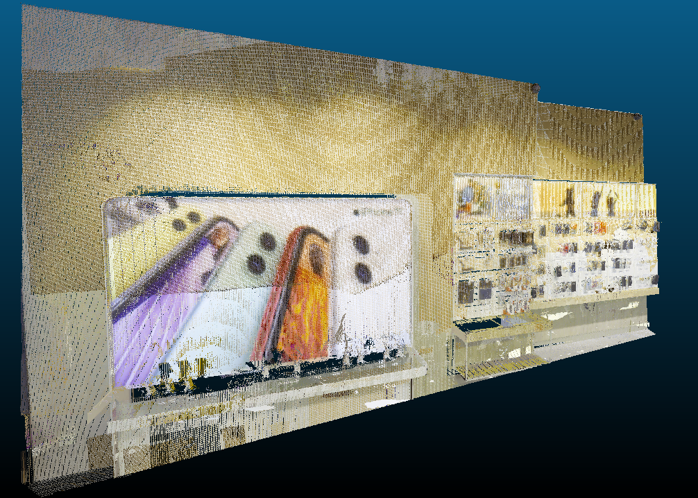

Thanks for your reply. I had a try with the smoothing with scalar fields and it works in smoothing out the rough patchiness but i cant seem to convert it back into its true colours and is stuck with the "SF RGB colours" This is the original colour. Was wondering if i went wrong somewhere when converting the colour back into RGB.
Appreciate your help on this.

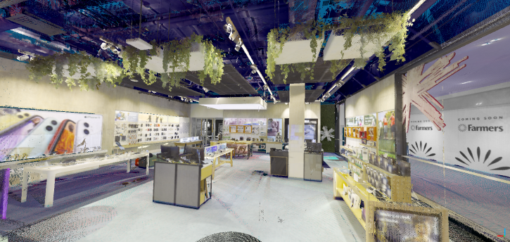

For anyone that is struggling with this issue, it is partially solved with Daniels recommendation above.
Converting RGB into scalar then individually smoothing each R,G and B value and reapplying the colour back into RGB through Colours -> From scalar fields. Alpha value is to be set to 255.
This is the original scan before this process: And this is the scan after the process Although not 100% clean, it does remove a majority of the granular effect and becomes more visually easier to read.
Hope this helps others too :)
