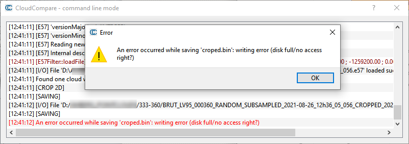

i'm using python to launch command line methods. When "auto saving" no problem, but when trying to explicitly save a cloud, it raises the error in the image.
any guidance would be apreciated.
thanks

Anyway, It was my bad. Once I passed the whole filepath (instead of just filename which was directing to working path a C:/) it worked as expected.
