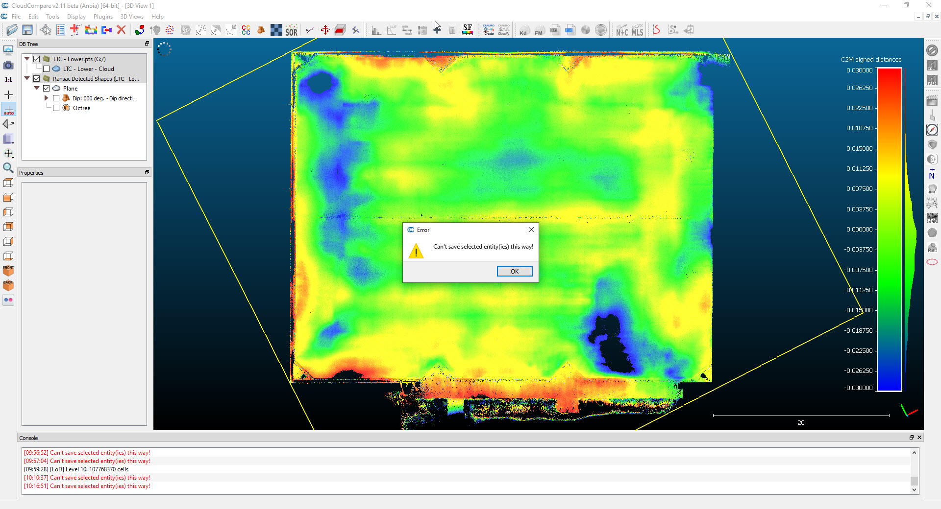

While trying to save my work. I get a "Can't save entities this way!" error. What am I doing wrong?
CC Saving Error.jpg (568.69 KiB) Viewed 21706 times

Warning, your selection is weird. You have selected two 'groups' (and a cloud inside one of the groups). What happens if you select only one cloud or one group?

Same error. :/

I just opened just to point cloud and tried to save it and i got the same error.

Can you send me the cloud maybe? (admin [at] cloudcompare.org)
Is it the latest beta release?

What file format are you trying to save this as, some don't support more than one object, or hierarchies (the folder structure), or meshes.

The PTS file is 26 Gbs. And my Box account won't allow me to upload it. Too large.

It starts as a PTS, are you saving it as that as well?

I just hit the save button and don't get any farther. I don't get the option to select any other format.

And do we agree that you only highlight one cloud for this test? (like 'LTC - lower - Cloud' or 'Plane')
