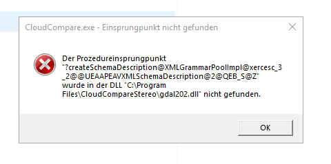

In my company we work with Faro Scene 2019. Since using Faro Scene 2019 in combination with CC with Faro plugin we cannot open the software anymore. The following error message always appears:
Der Prozedureinsprungpunkt "?createScemaDescription@XMLGrammarPoollmpl@xercesc_3_2@@UEAAPEAVXMLSchemaDescription@2@QEB_S@Z"wurde in der DLL "C:\Program Files\CloudCompareStereo\gdal202.dll" nicht gefunden.
Does anyone know how I can solve this issue? Or where this issue is coming from?
Best, Sara
Re: CC with Faro LS plugin cannot open
Yes for now either you uninstall CC and reinstall it WITHOUT the FARO plugin... or you revert to an older version of CC... That issue is a big problem we currently have with the latest Faro SDK...
