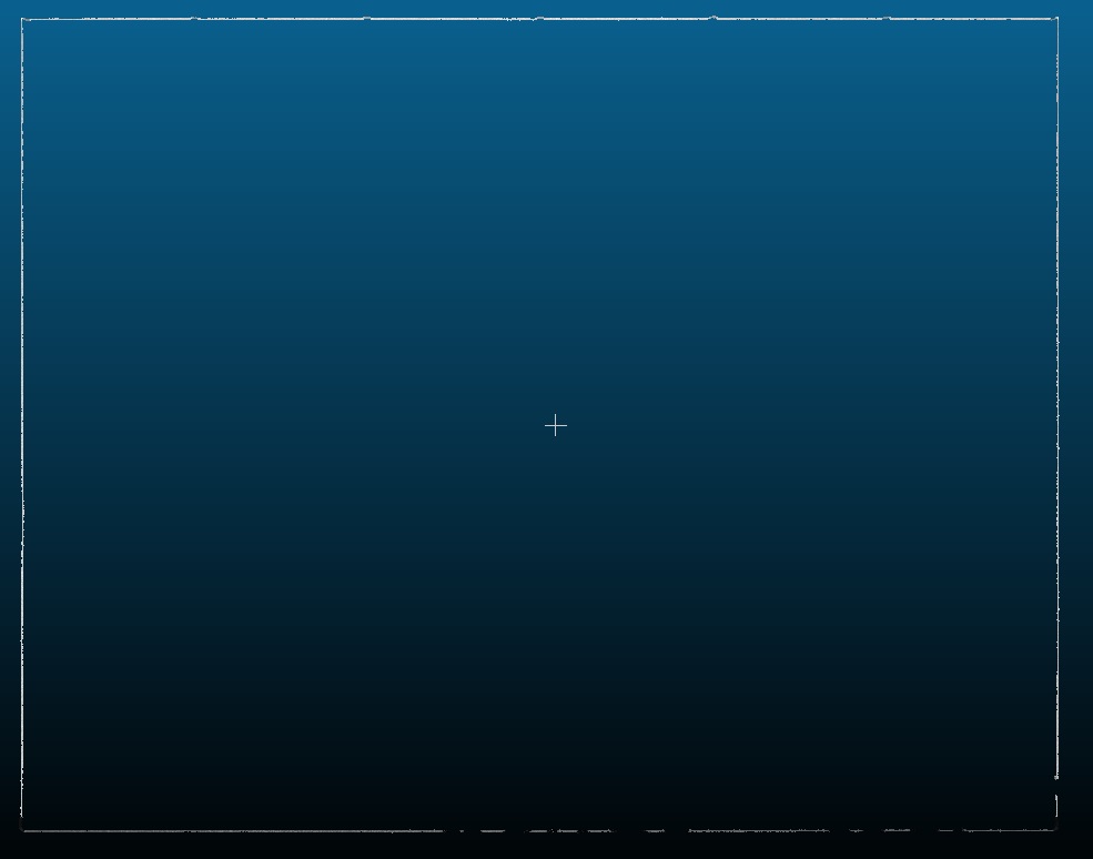

I have this section slice of a point cloud:
Is there a way to auto generate polyline(s) tracing the center of the point cloud formations (maybe based on point density or 2d surface geometry)? I know how to extract the concave hull contour from the Section Cut menu, but I will only get the outer contour.

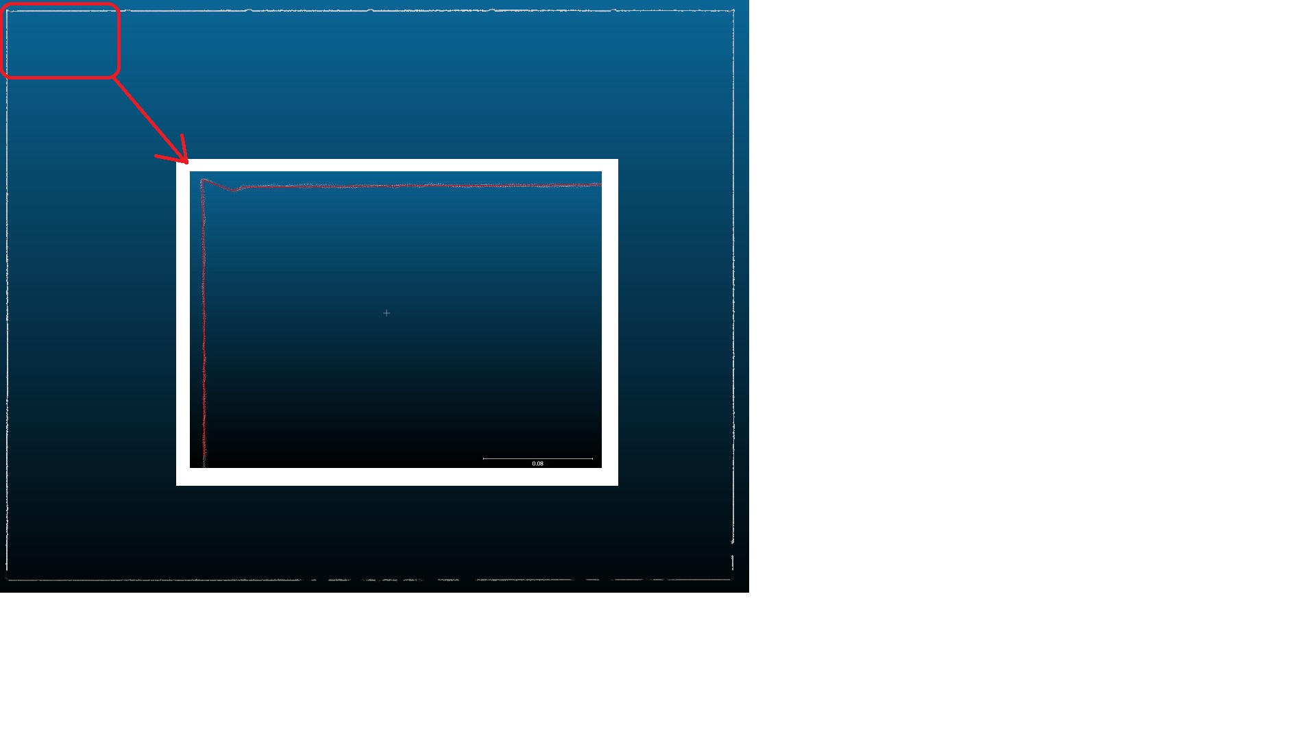

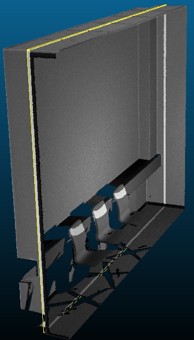

I have this scan segment of a niche:
I will cut out a slice of this niche and manually trace the center of the point cloud with a polyline:

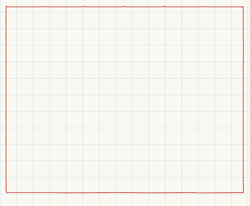

The resulting polyline looks like this:
I would like to know if it is some how possible to automate this process (of tracing the center of the point cloud slice with a polyline) with cloudcompare?
