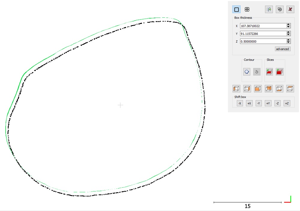

In a more limited way, you can use the Cross Section tool (or 'Clipping box') with the two (or more) entities selected. Then clip the points you want to compare - typically with a thin slice - and eventually hide the box interactors so as to only see the points (you can even set the view parallel to the cut).

I'm confused. Which are you using here? The Cross Section tool? (then you have to use the colored torii if you want to rotate the clouds, and you have to move the mouse horizontally or vertically depending on the axis).
But in general I wouldn't advise using any manual registration. You can extract some slices if that's what you want to use as reference, and then apply a proper registration tool (Point-pair alignment or ICP). And eventually use the resulting transformation matrix (output in the Console) on the original cloud for instance.
