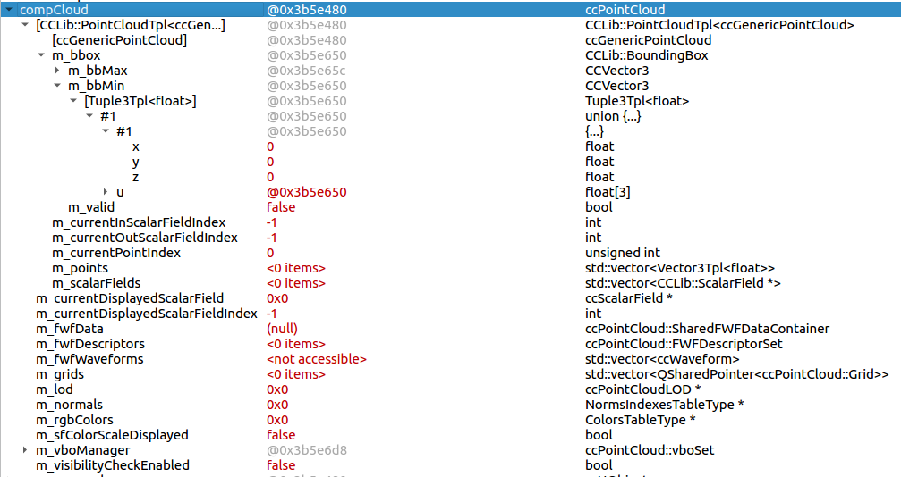

When I debug I get that, after the casting, the cloud is apparently empty even though is displayed in the viewer without problem.

comp_example is a ccHObject instance (a 'group' object). You cannot convert it to a point cloud directly.
You have to look for its children (normally there should only be one if you load an ASCII file) and this child should be a point cloud. Pay attention that ccHObjectCaster::ToPointCloud may return a null pointer (if the input entity cannot be converted to a point cloud).
Re: Problem with empty ccPointCloud
And if the cloud is empty, it's for a reason. No need to 'resize' it to make the function 'work'. As there will be no valid point in such a cloud.

daniel wrote: Wed Mar 13, 2019 8:10 pm comp_example is a ccHObject instance (a 'group' object). You cannot convert it to a point cloud directly.
Thanks! I was sure that i have tested with getting childs from the ccHObject but there must have been other mistakes when I tried. Now I'm dealing with some errors in the cloud2cloud distance calculation but, at least, my clouds have some points!
