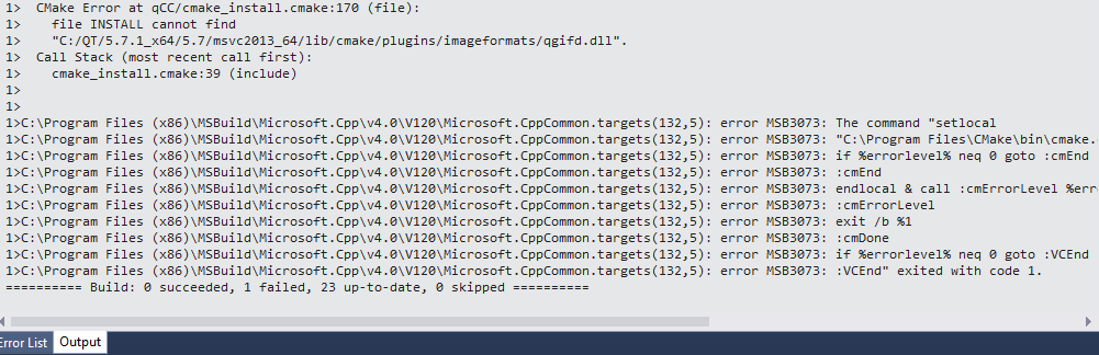

When I build the project "INSTALL", I get always the error of MSB3073 as the image attached. But in my install folder 2 folders are still generated ( cc_Viewer_debug and CloudCompare_debug).

Posted: Wed Oct 31, 2018 7:36 pm
So, does the 'qgifd.dll' file lies in the specified folder? (C:/QT/5.7.1/...)
Because apparently it cannot be found if I believe the message in the console.

Yes, you are right. Now it is solved.
The problem comes from the wrong path of QT5_ROOT_PATH that I gave as this one (C:/QT/5.7.1_x64/5.7/msvc2013_64/lib/cmake).
The correct one should be C:/QT/5.7.1_x64/5.7/msvc2013_64.
