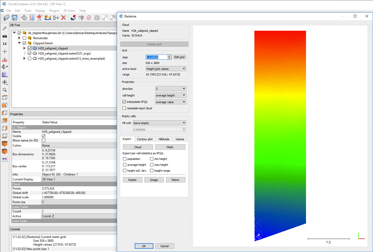

I'm trying to create a raster of my point cloud at 1 cm resolution using the average cell height, interpolating with the average cell value, and no resampling (see screenshot of parameters used).
Screen Shot 2018-09-19 at 11.32.39 AM.png (233.73 KiB) Viewed 5875 times

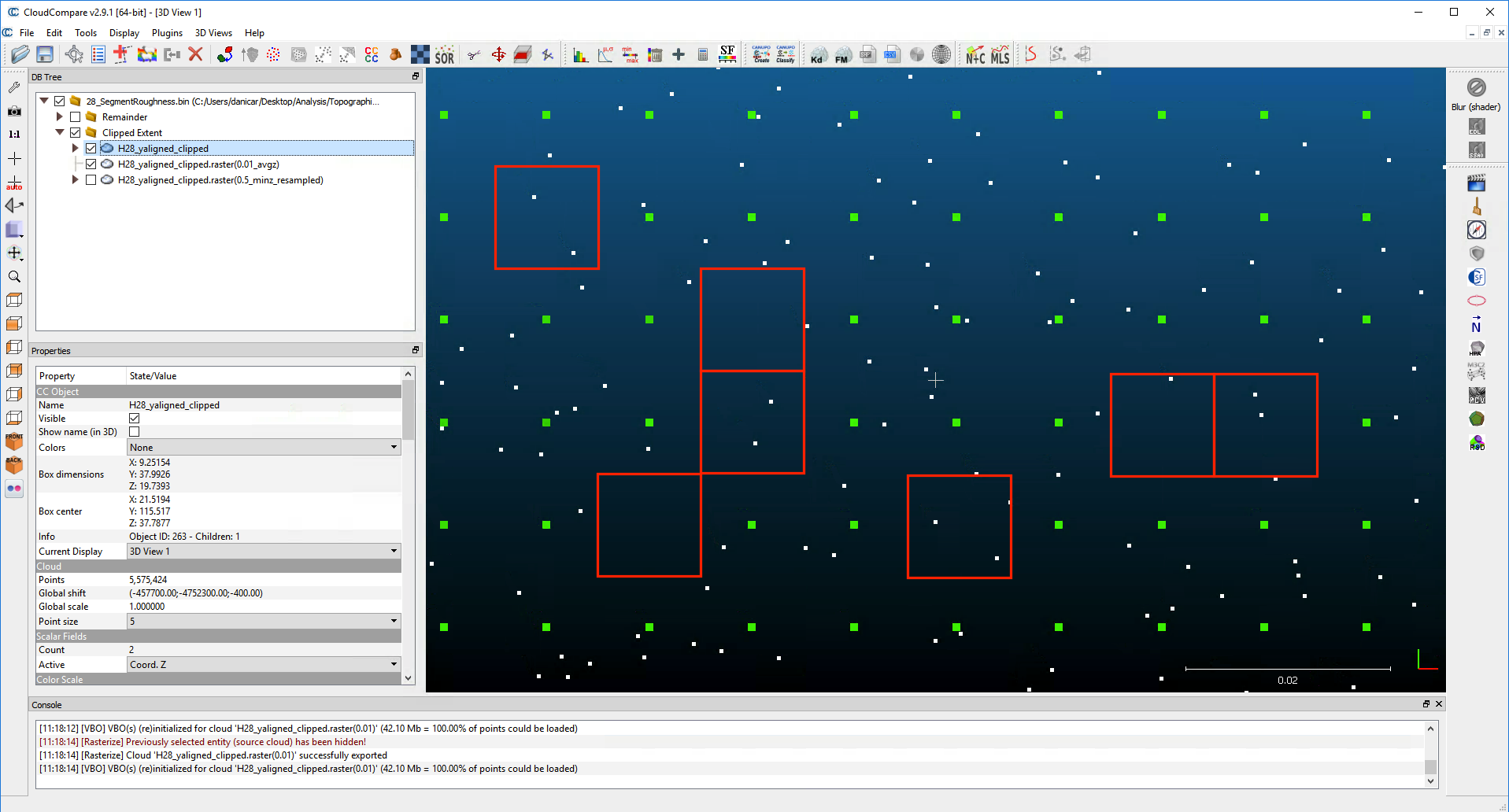

The resulting raster has holes where the original cloud definitely had enough points that it should have been able to get a value... please see the attached screenshot of a zoomed in portion of the original point cloud (white points), rasterized 1 cm cloud (green points), and holes in the rasterized cloud (indicated with red boxes).
Screenshot of zoomed in cloud and holes.
Screen Shot 2018-09-19 at 11.22.32 AM.png (373.54 KiB) Viewed 5876 times
Am I doing something wrong when rasterizing this, or is this a bug? Please help! Thank you in advance!!
