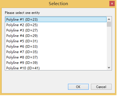

My question is I want to segment a pointcloud with more than one polyline,when I use segment tool,it only able to select one polyline at a time,but I have a lot of polylines . Is there any way to select many polyline at one time or any other way to solve my problem?

Are you speaking about a segmentation 'inside' the polygon? With the scissors tool? Then you may achieve this with the command line tool (see the CROP2D option: http://www.cloudcompare.org/doc/wiki/in ... _line_mode).
Otherwise if it's extracting a profile / contour along the polylines, then you have the 'Extract sections' tool.
