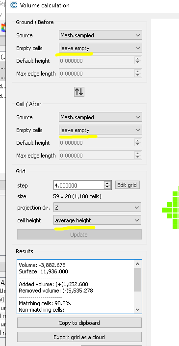

Use leave it empty otherwise you can get wrong results
Start with small grid then increase until shape of grid is regular and volume is stable

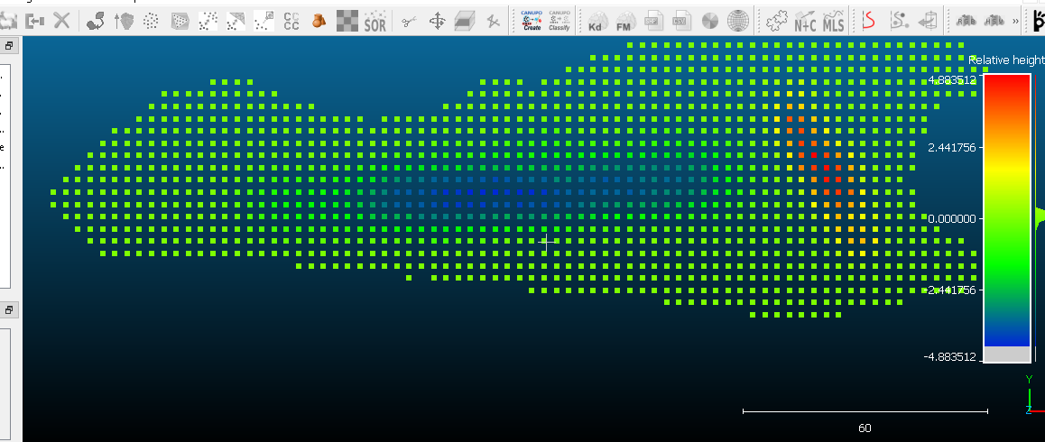

This is OK

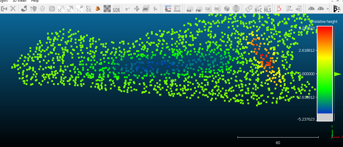

This is not OK because alot of holes , grid is too small compared to cloud density
You can check attached file for easy testing
