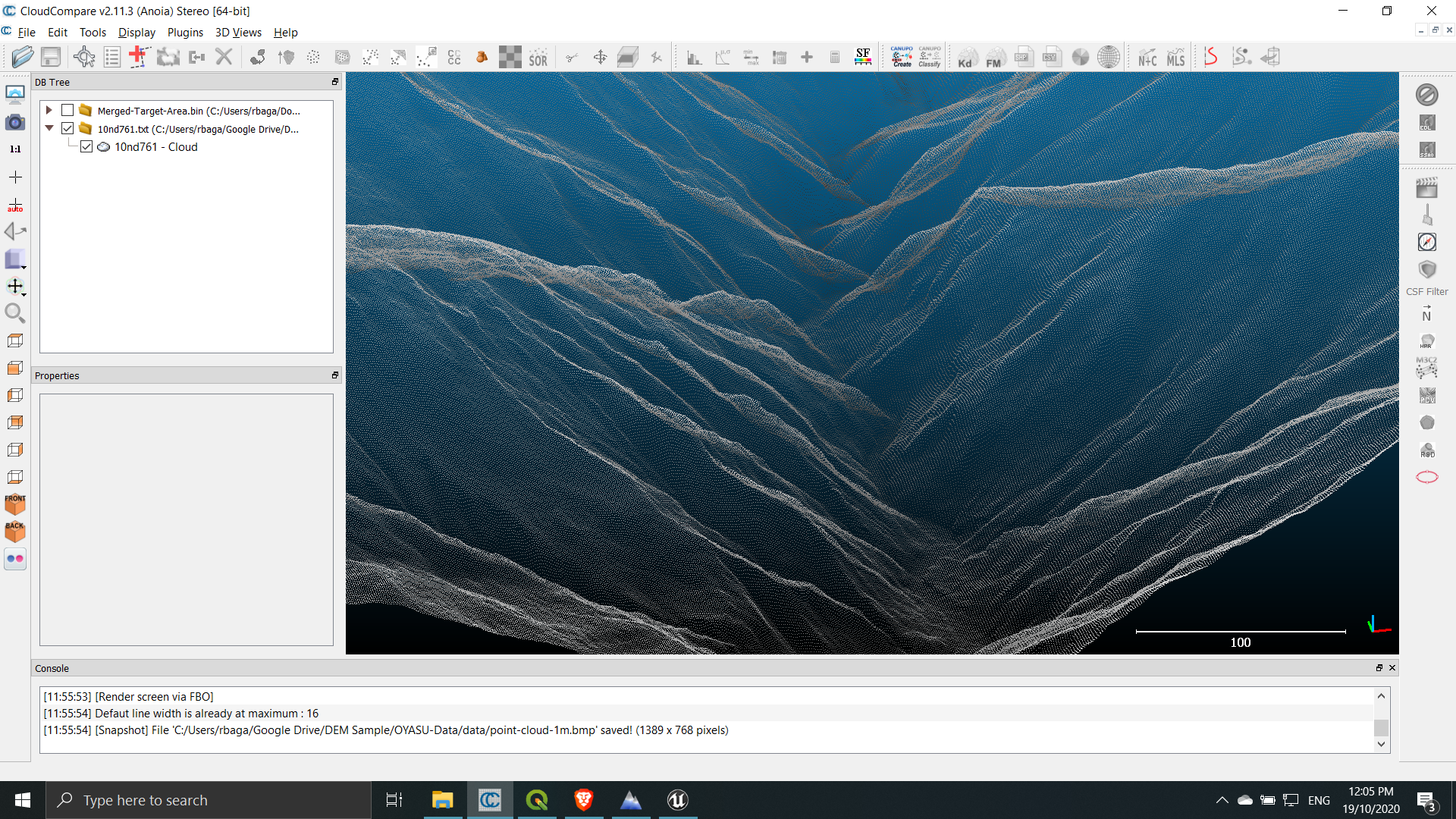

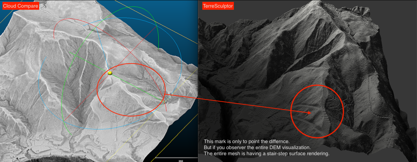

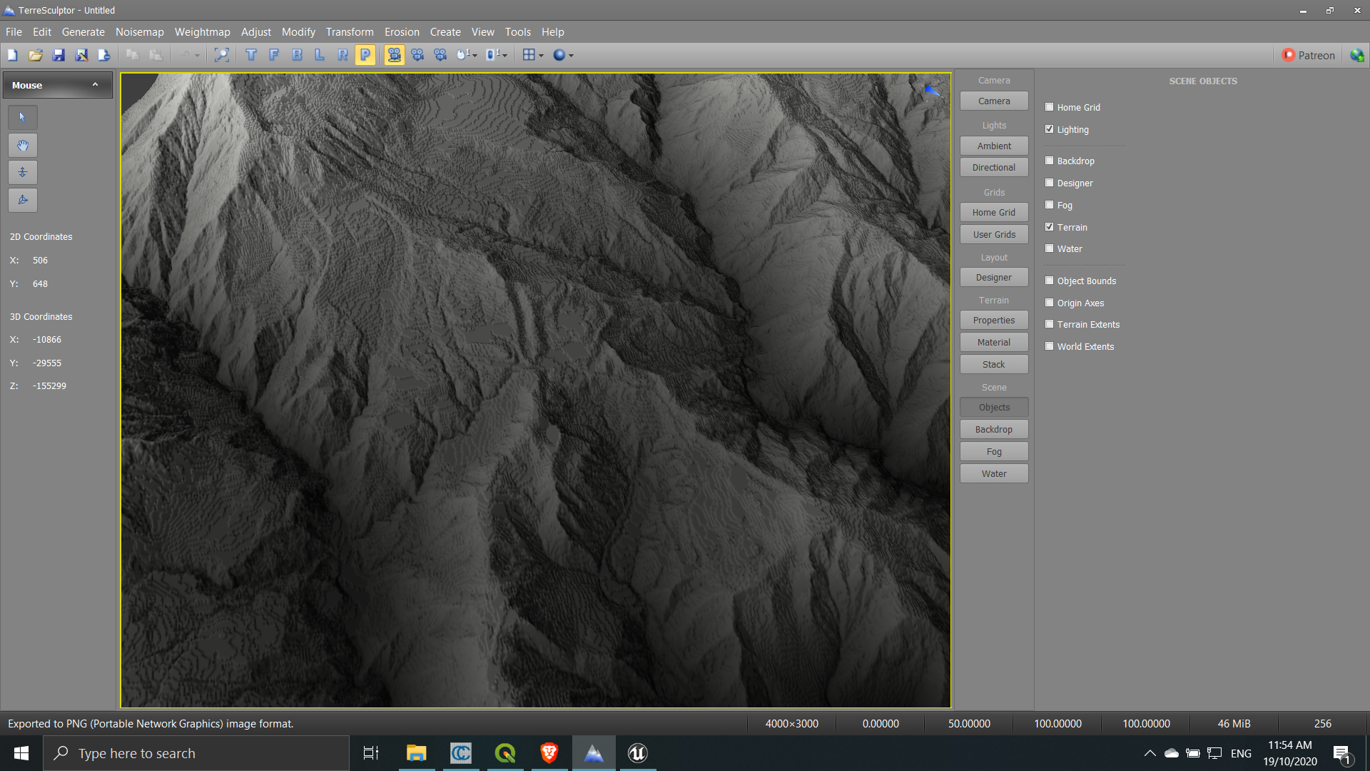

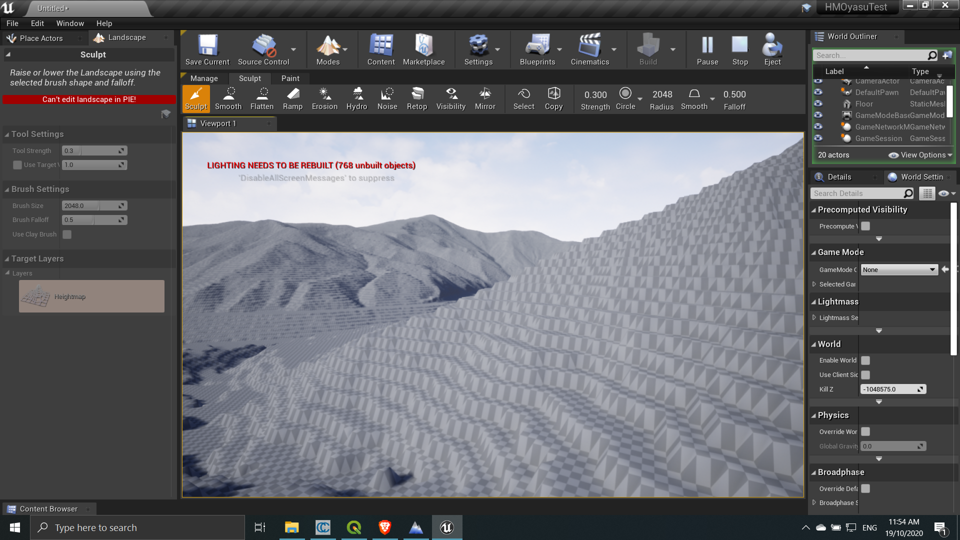

NOW, we are able to troubleshoot data importation, that means that the terracing effect in the 3d mesh is probably not an issue with data interpretation. It seems like the interpolation is was correct when creating the raster image.
Is there some sort of TIN interpolation or data extrapolation in Cloud Compare?
We took a 1m lidar resolution for a mountain, inside Cloud Compare, the visualization seems accurate but the rastered image doesnt seem to interpolate between points hence the terracing effect. Here's the screenshot from Cloud Compare to TerreScultor to Unreal Engine
