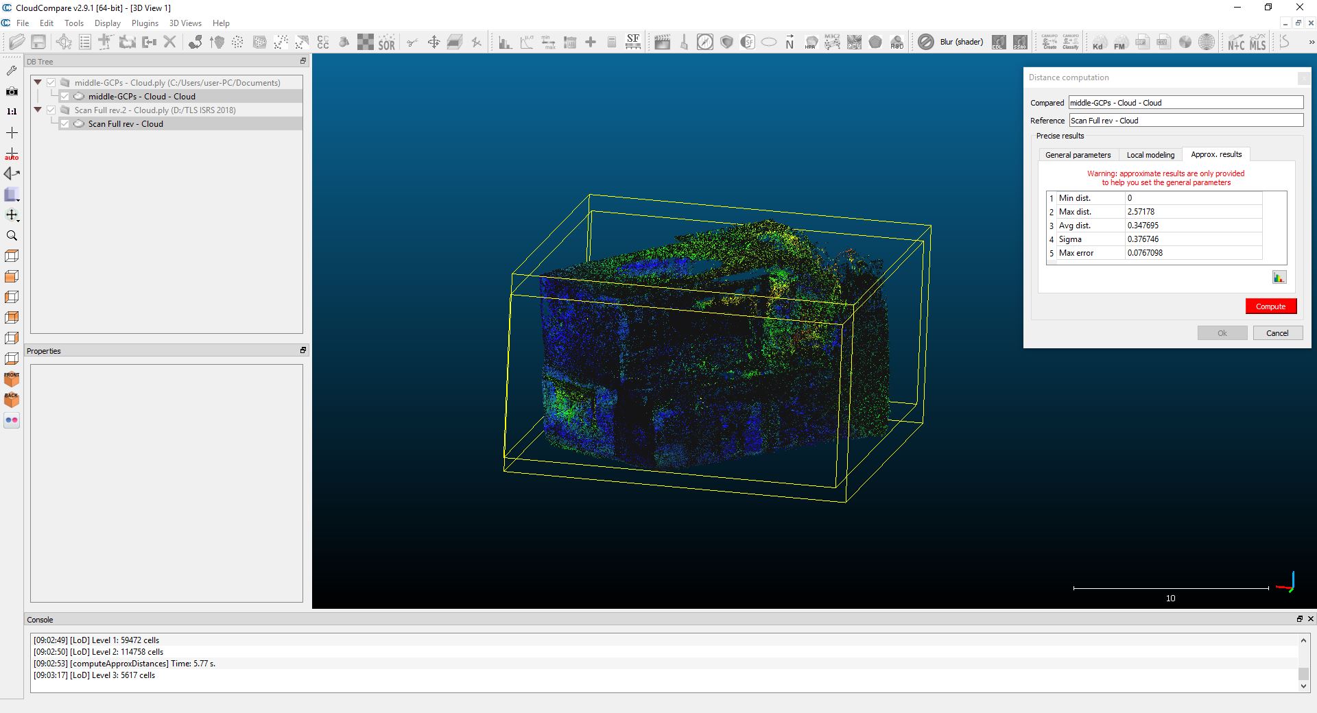

Do you know the meaning of min. dist, max dist, avg dist and everything in Distance computation?
Re: C2C distance - Local modeling - radius (sphere) value
Those are only very rough estimates pre-computed by CloudCompare before the user can actually compute the real distances. They should basically be ignored (it's just here for very advanced user who wish to change the octree level to speed-up computations in some tricky cases ;). They are computed thanks to a distance transform on a grid and are therefore very inaccurate.
You have to compute the distances first (with the red button), and then look at the generated scalar field properties (or the histogram, or fit a statistical distribution on the distances values, etc.) to get real statistics on the true distances.
