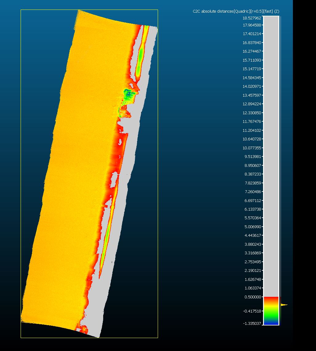

Hello, again!
I want to export the result of C2C distances. I tried the .cvc file after splitting in X, Y and Z but the values I get for Z in the file differ significantly from the ones displayed in the cloud according to the scalar. Why could that be? How can I fix it?
Also, I would like to export the result (cloud AND scalar) an an image. I tried the TIF file but it doesn't open: it's damaged or too big or not supported..Is there another way to do that?
Thank you!
Re: Cloud to cloud distance
Posted: Thu Dec 14, 2017 3:12 pm
by Ioanna
And also, I get negative distances, although I read under another question that C2C always returns positive distances. Is that right?
Posted: Thu Dec 14, 2017 8:25 pm
1) What is the 'CVC' file? Do you mean a text/ASCII file?
In this case, try to save the 'columns title' as well (see the 'Save ASCII file' dialog). This way you'll be sure to look at the right column (you may mix it with another one). The scalar fields should be at the end (after the X Y Z coordinates, and potentially colors and normals).
2) To export the view as an image, you should use 'Display > Render to file' (with PNG or JPG extension typically). Otherwise you may be trying to save the cloud as a raster, which is not a standard TIFF image, but a 64 bits geo-tif file.
