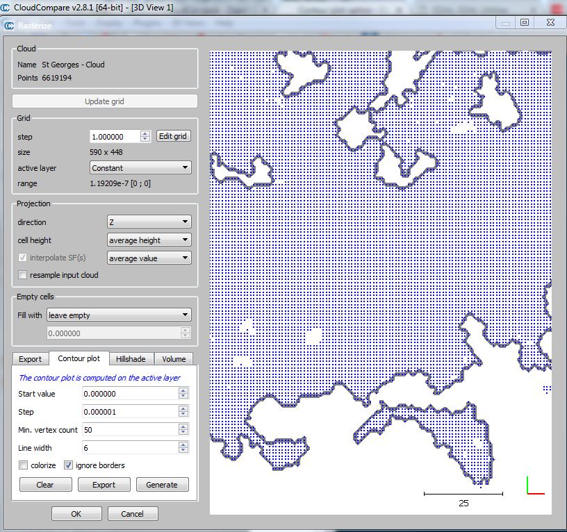

Borders appears in version 2.8.1 (but not project on the altitude layer) :

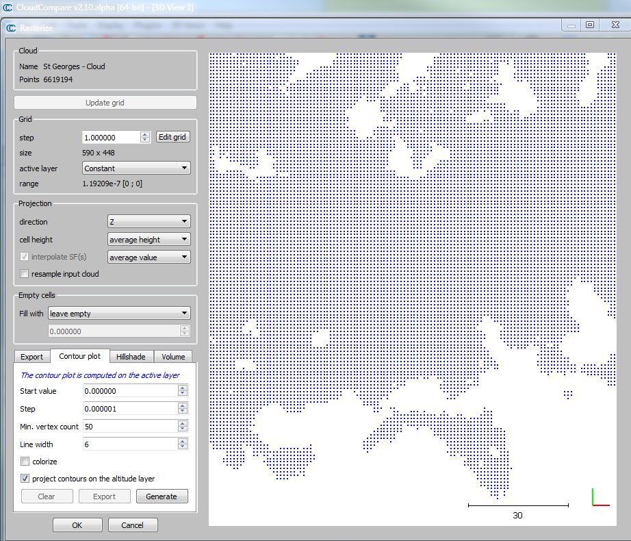

Impossible to reproduce borders in version 2.10 alpha (and 2.9.1) :
2.10 alpha.JPG (250.68 KiB) Viewed 9744 times
It worked in 2.9 beta (and contours was projected on the altitude layer :-) ) but I have lost this version

As I said, this option really has disappeared (the library we use to generate contour lines in the 2.10 version doesn't have this option).
Can you try to set the 'Empty cells' to 'custom value', set the value (below the combo-box) to something smaller than the altitudes in your raster (apparently it's all 0, so you can set it to -1 for instance) and eventually generate the contour lines?
