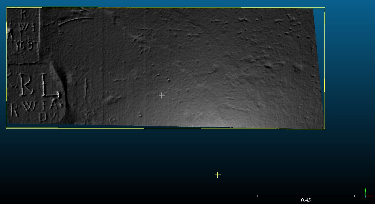

If it's only for display, you can use the normals with the custom light:
Simply compute the normals with a not too big radius (so as to capture the small details - here I chose 0.005) and with the right direction (as you have a flat wall).
Then:
- toggle the light off (F6)
- toggle the custom light on (F7)
- find it (it's a yellow cross, that can be quite far from the cloud sometimes ;) and bring it closer to the cloud with CTRL + right mouse pressed. It may be wiser to do it before computing the normals as display with normals is quite slow.
- position it so as to obtain a raking light
I believe another way would be to use PCV, but it may depend on the noise level. I'll try that on my side.

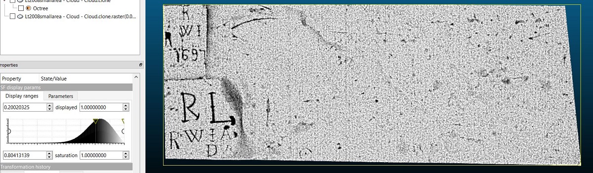

Make sure the (wall) plane is aligned with XY (you can use the Level tool). Then use PCV with a big resolution (e.g. 2048) and a lot of rays (e.g. 1000). Then increase the saturation of the resulting scalar field.
It may not be as clear as the previous view with the normals (because of the noise) but at least you don't have to play with the custom light position.

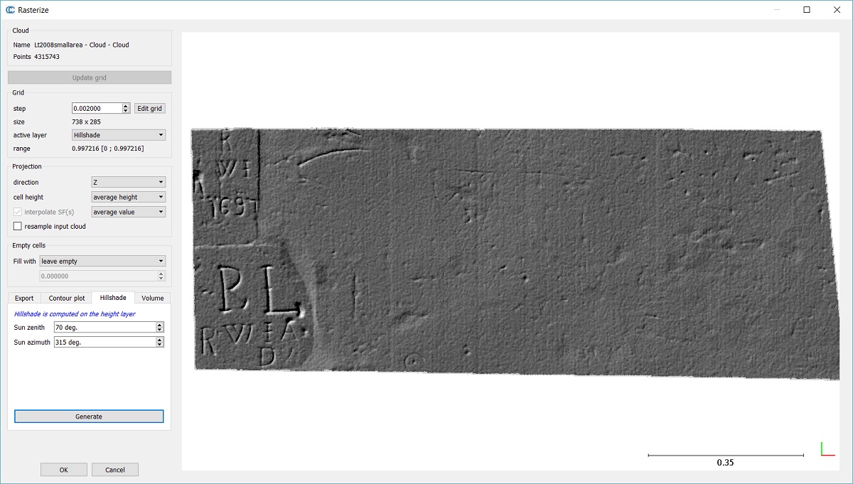

Last but not least you can also use the hillshade option of the Rasterize tool:
Once again it would be better to set the plane (wall) parallel to XY or YZ. Then use a not too small grid step (e.g. 0.002) to smooth the cloud a little bit.
And then generate a 'hillshade' layer with a raking light (> 70 degrees). You can play with the azimuth angle to enhance the carvings depending on their orientations. You can also export the resulting grid as a cloud (with the hillshade values as a scalar field). And you even once again enhance this scalar field saturation.
