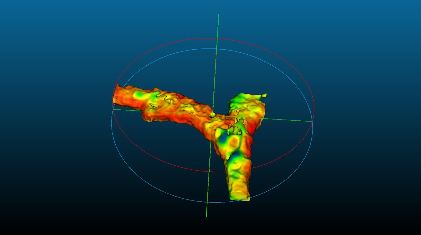

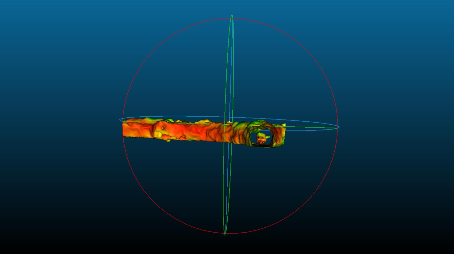

I am trying to unroll a tunnel in which I have collected point cloud data using a mobile robot. The problem is that the tunnel is very irregular and is not straight. I have been looking through the help comments and these seem to be the most relevant:
Unroll - Parabolic
http://www.danielgm.net/cc/forum/viewto ... roll#p5500
Texture of collapsed towers
viewtopic.php?t=1417#p5456
unroll texture
http://www.danielgm.net/cc/forum/viewto ... roll#p3820
That being said I am not getting great results. Any suggestions would be most appreciated.

Wow, this is going to be hard... frankly I don't see how to handle this case :(

Re: Unrolling a tunnel
Oh Sweet!!! Do I win a prize since I stumped you? :{)
Like I said, I think creating a polyline is the best way to go, but I have had little luck.
I have a similar project, but with lava tubes. Cutting the tube or cave into segments worked well. Find segment that are most like a cylinder and treat them separately.
