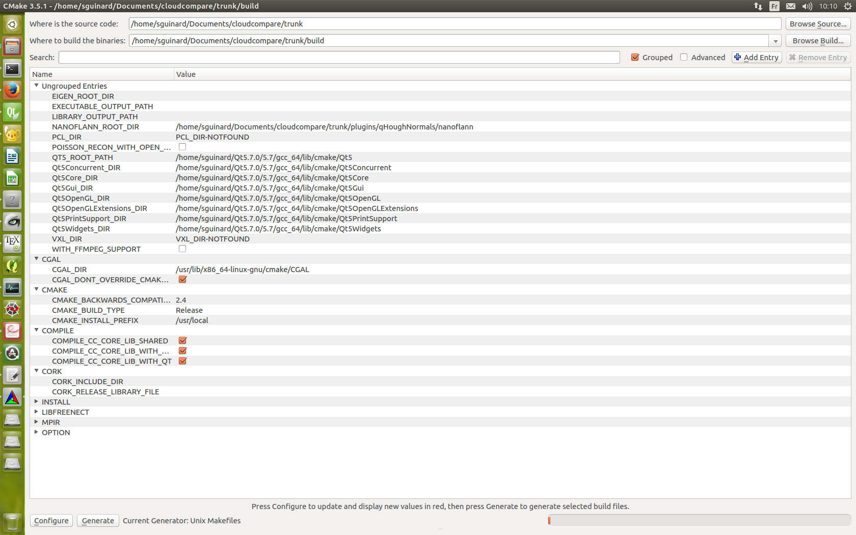

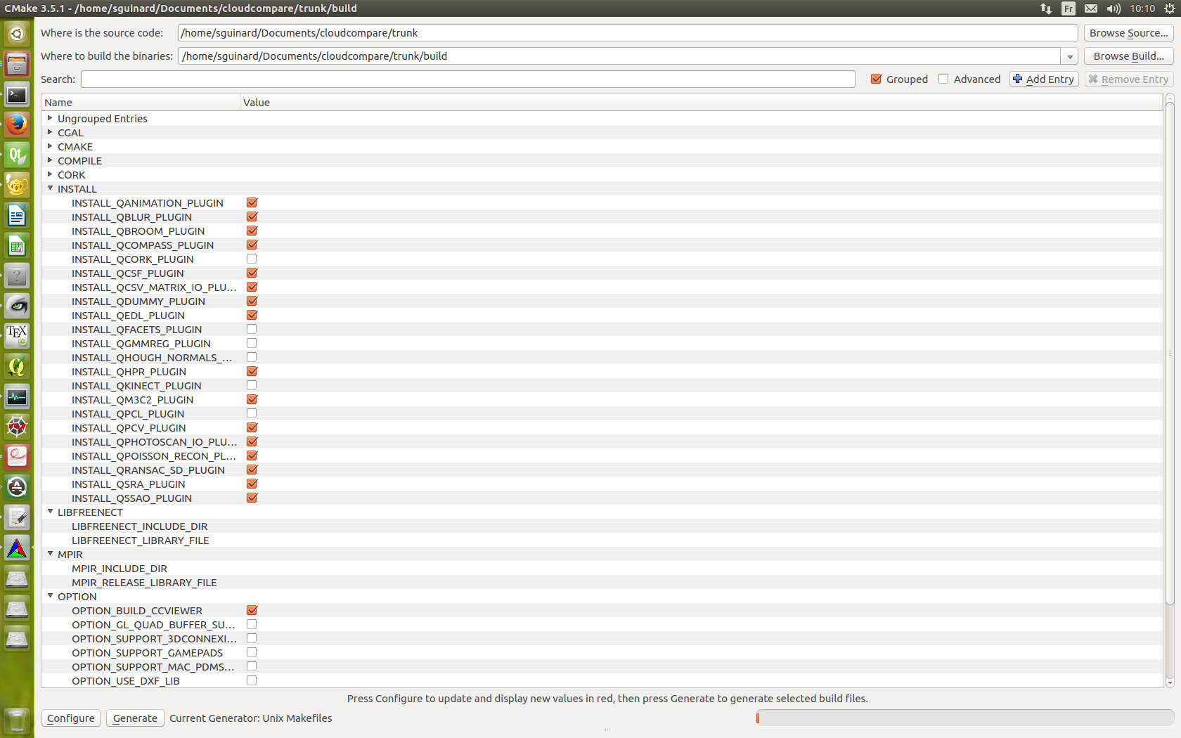

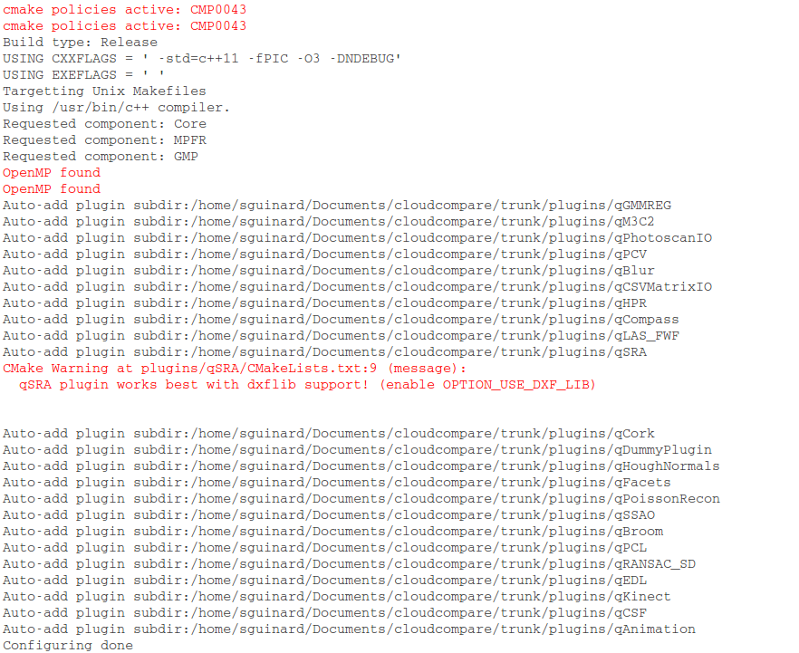

Can you provide us with your CMake configuration? (one or several screenshots would be good)
Re: loading plugins with CC 2.9 beta on ubuntu
Thanks for the quick answer
The options are in the cmake-1 & cmake-2 images and the configuration is in cmake-3

- options 1
- cmake-1.jpg (168.69 KiB) Viewed 30888 times
- options 2
- cmake-2.jpg (156.66 KiB) Viewed 30888 times
- configuration
- cmake-3.png (152.29 KiB) Viewed 30888 times

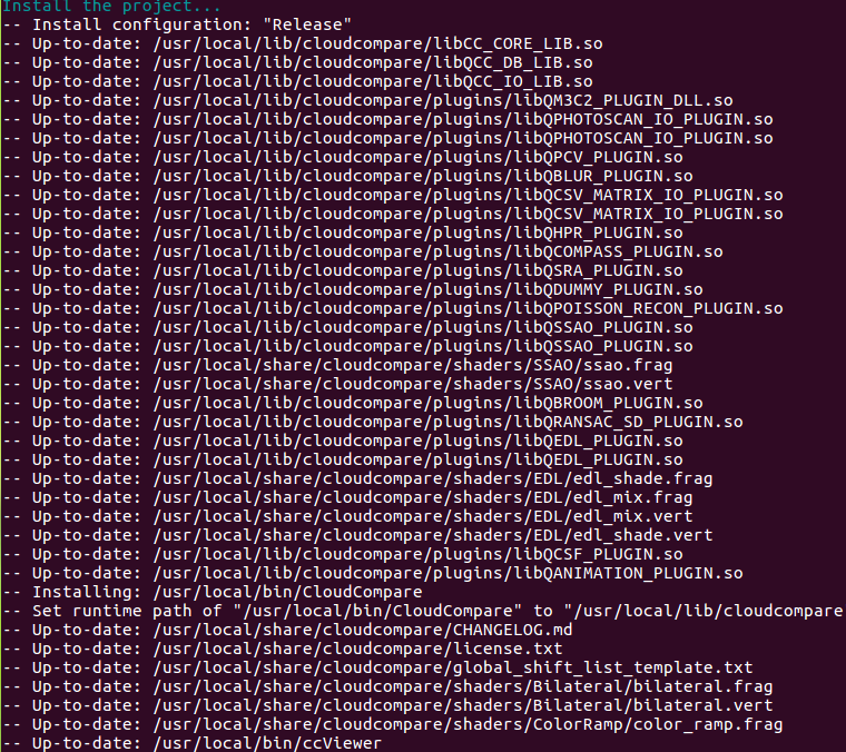

And the installation is in cmake-4
- installation
- cmake-4.png (182.83 KiB) Viewed 30888 times

I'm afraid to not understand the issue here.
the runtime path point to '/usr/local/lib/cloudcompare/plugins' as proved by your last printscreen
