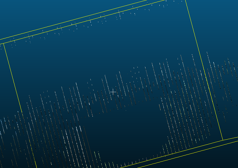

I'm currently having issues with the export .ply function in cloud compare. I'm importing a .pts file of a bridge structure which is visible in full density in CC. I'm looking to export this as a .ply for another meshing software however during export the data is reduced to a low density grid (see attachment). I have exported both in binary and ascii formats to no success. I'm running CC v2.9 but have tried previous versions, has anyone had a similar issue with exporting .ply?

And regarding the 'low density' issue, it looks like an issue with the precision. Are the coordinates of your input cloud large? Have you accepted to shift them to a local coordinate system when prompted by CloudCompare? (if not, you should ;).

Morning,
When bringing in the .pts file I've allowed CC to do a coordinate scale and shift. I'm still getting a 'low density', grid of points rather than the full density.
Reduced density after save as .ply

Hopefully the image will give you a better idea of what the issue is, open to any more suggestions,

Can you post a snapshot of the Global Shift & Scale dialog?
