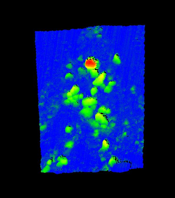

I want rasterize a pointcloud which results from a comparison. Like that :
[img]
[/img]

so it is not the result that I want. May be I'm wrong on the programmation but how i can obtain a raster of my cloud ?
