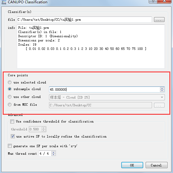

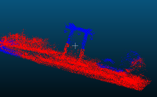

I feel the result of classification training well from the dialog of CANUPO training and the Statistics.
And use this .prm,what's the meaning of the Core points on the dialog of CANUPO Classification.
The result of classification is not good.

@Bonnie: no, the '1 cm - 1m' range was only an example. It depends on your cloud units AND on the objects scale! If what I see on your screen capture is an electric pylon, then the scale is probably much bigger.

@ daniel:The terrain of mountain is very complex, the elevation is very difference too,And there are many high trees and vegetation,i have trid many times ,can i really get good result?

I don't think the terrain is the problem (I have seen very complex scenes properly segmented). Generally the issue is more with the data. You need dense LIDAR point clouds such as TLS scans. I'm not sure an airborne scan is dense enough.
Don't hesitate to send me a cloud sample if you want me to try (cloudcompare [at] danielgm.net).
