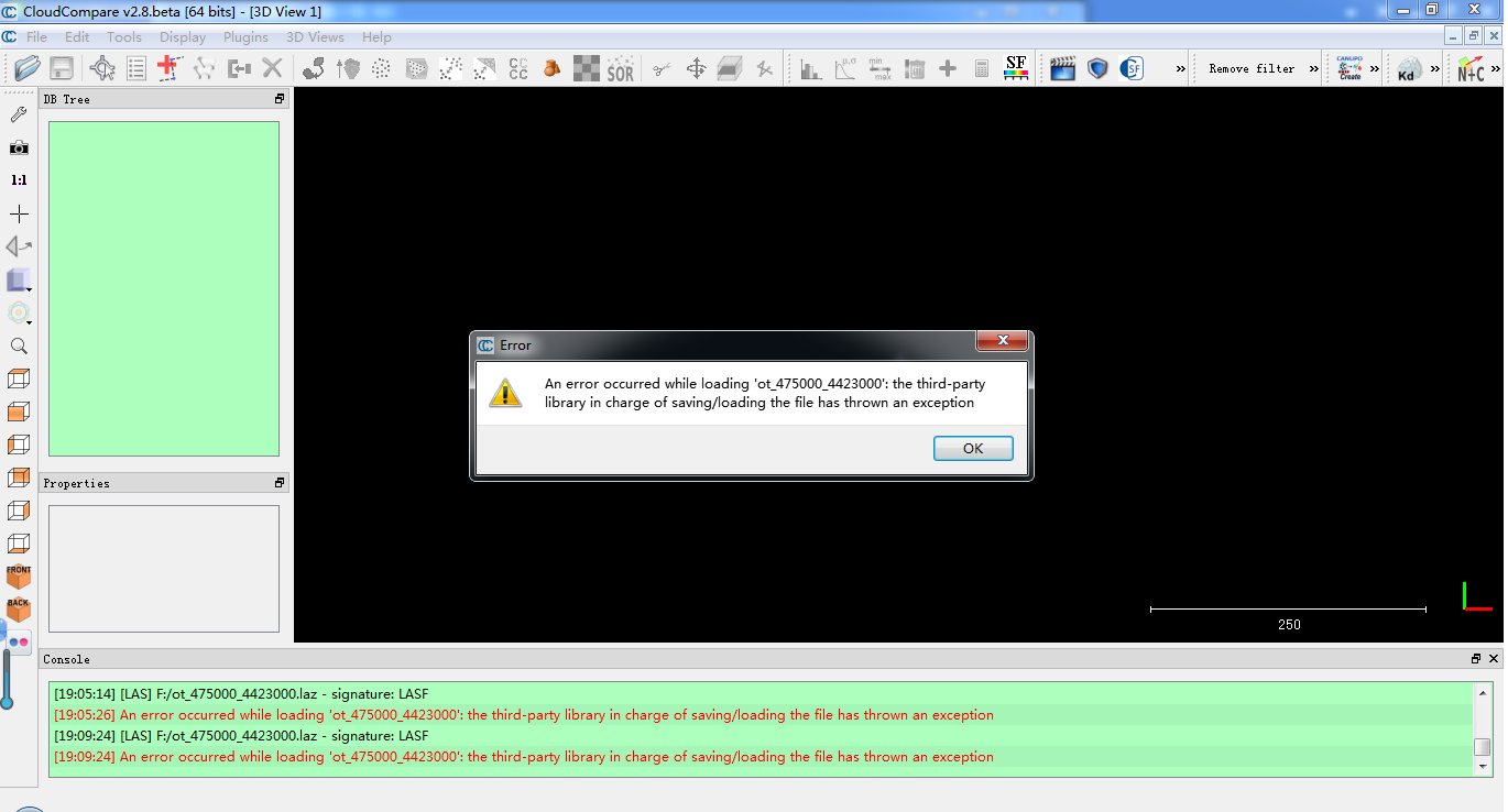

I use cloudcompare to open laz file, but it can't be opened and there is a message as the follow picture shows.I don't know why it happens, is there anyone who can help me?
error in opening laz file

Hum, two options:
- either the LAS version is too high (1.3+ or 1.4). Lliblas doesn't handle them. You can try to use the other file 'filter' named 'LAS 1.3 or 1.4' in the file loading dialog. It relies on the LASlib and hopefully it should work better.
- or there's another bug, in which case I would be very interested to get the file. You can send it to me to 'cloudcompare [at] danielgm.net.
