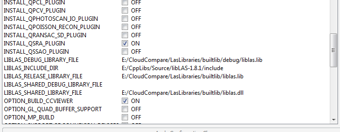

I built cc on Windows 7 using QtCreator(Qt 5.7.0 Msvc 2015 x64). Everything looked fine but I am not able to debug the plugins. In debug mode the plugins menu is disabled. As shown below, only QSRA plugin is enabled. Use_LIBLAS is OFF(i had doubt whether this was causing issue).
Any idea why this happens? When i look at the console, it has this message there.
[12:54:19] [Plugin] File 'QSRA_PLUGINd.dll' doesn't seem to be a valid plugin	(The plugin 'E:/CloudCompare/install2015/debug/CloudCompare/plugins/QSRA_PLUGINd.dll' uses incompatible Qt library. (Cannot mix debug and release libraries.))

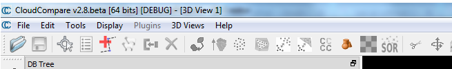

Re: Debugging when plugins are enabled
In the title bar of the main window, what do you read?
vinayan
Posts: 27
Joined: Thu Nov 03, 2016 4:11 pm
Post by vinayan »
hi,
It is 2.8 beta as shown below. Anyway , I am getting around without debugging using old school logging.
I just wanted to make sure that the application was compiled in DEBUG mode... But this is puzzling, because it implies that the plugins are compiled in release mode?!
