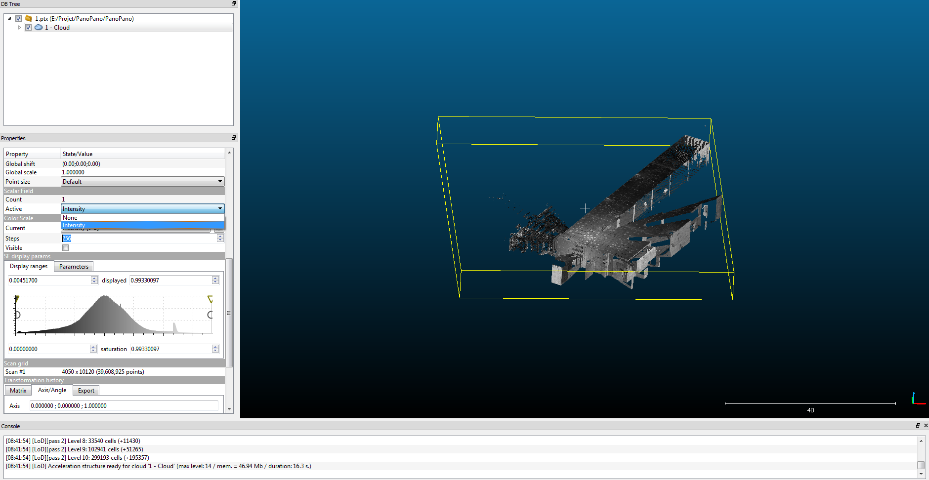

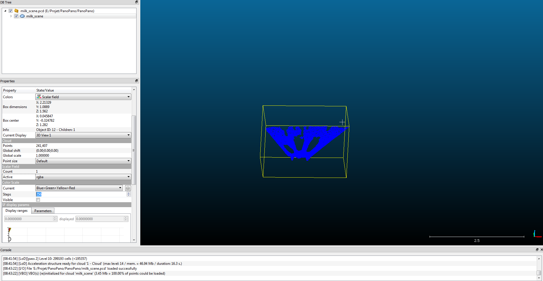

I Will post screenshot, 1 photo equals to 1000 words as we say!
But, when I open the image that works with PCL in CC, it becomes all blue (cf expl2), and when I reexport it, colors had disappear :/
- The file that "works"
- expl2.png (55.56 KiB) Viewed 11879 times
- The file I want to convert to RGBA
- expl1.png (143.04 KiB) Viewed 11879 times
Re: Create RGBA scalar field exporting PCD
Hum, the first cloud does have an 'rgba' scalar field, but it seems to be invalid?! Maybe the PCL importer failed. This would explain why you can't export it properly.
