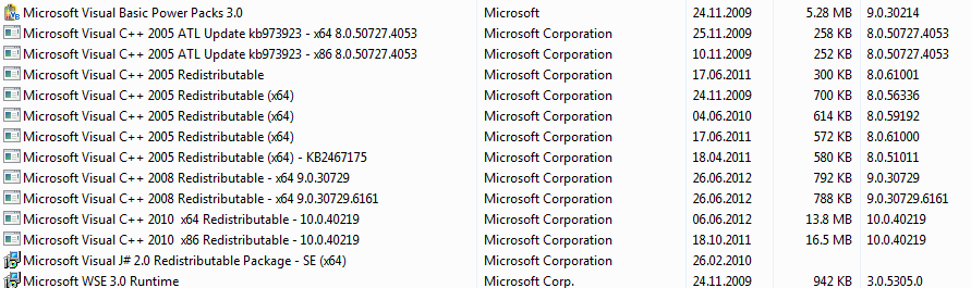

I tried a lot of installing/deinstalling. However, I got the same problem. The C++ RP SP1 is not shown as SP1 under installed programs. See picture. What about all the other packages?
The 32bit version works, so no hurry.

Hum, I'm quite astonished to see how many people have this problem, while the project is compiled with Microsoft tools on a Microsoft OS...
I'm currently trying to generate the whole project with Visual 2010 instead of Visual 2008 (as it seems that it's the heart of the problem).
Meanwhile, you can still use the 32 bits version as before. I hope I'll get a running version soon.

Re: CC vers.2.4_06_24_2012 will not run
Thanks for the test.
I'll upload in a few hours a new version (compiled with MSVC2010) that fixes the issue.
Works now!!!!
Thanks for your quick answers and work.
