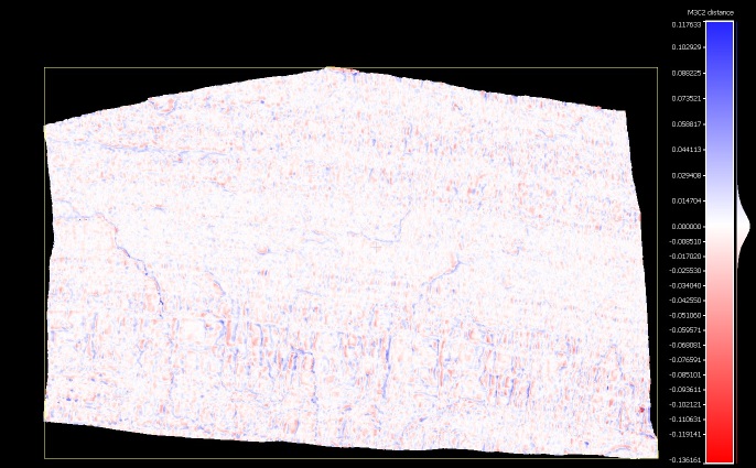

I'm a new user of CloudCompare. After I red the scientific paper on the M3C2 algorithm, I'm trying to estimate mathematically the scale D and the projection d on my point clouds. For this purpose I've tried to calculate the mean roughness sigma(D), using the tool, on the reference cloud and multiplied it by 25 to estimate the scale D. Moreover, since the density of the reference cloud is almost 4 pts/cm², I thought that d = 0.1 m should be suitable to include a large number of points. Is the calculation method above right?
I've tried to compute the M3C2 distances between two point clouds related to a Cliff oriented along the IV quadrant (X, -Y) with the following settings: Scale= 1.5, projection= 0.2, Max depth = 1.5, Calculation mode= Default, preferred orientation = -Y. In attachement you can find a print screen of the M3C2 results. I noted an incorrect sequence of negative and positive distances (Red and Blue points).
Do you have any idea about the origin of this erroneous effect? Is it related to the orientation of the Normals?

Yep, the normals orientation is a key parameter of M3C2.
What is the global orientation of the cloud(s)? And the scale? (can you show the trihedron and the scale bar?).
And what parameters do you get when clicking on the 'auto' button of M3C2 (as a comparison basis).

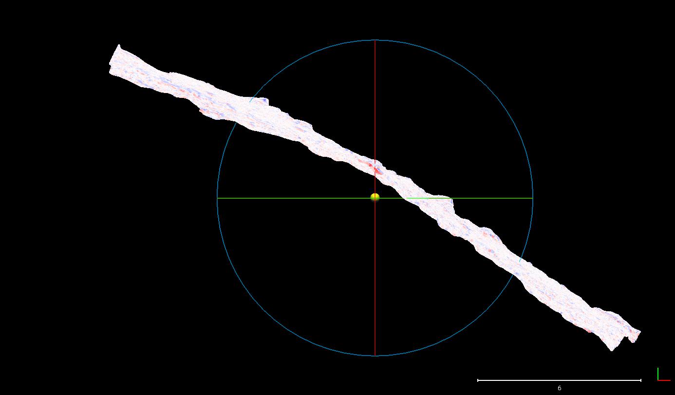

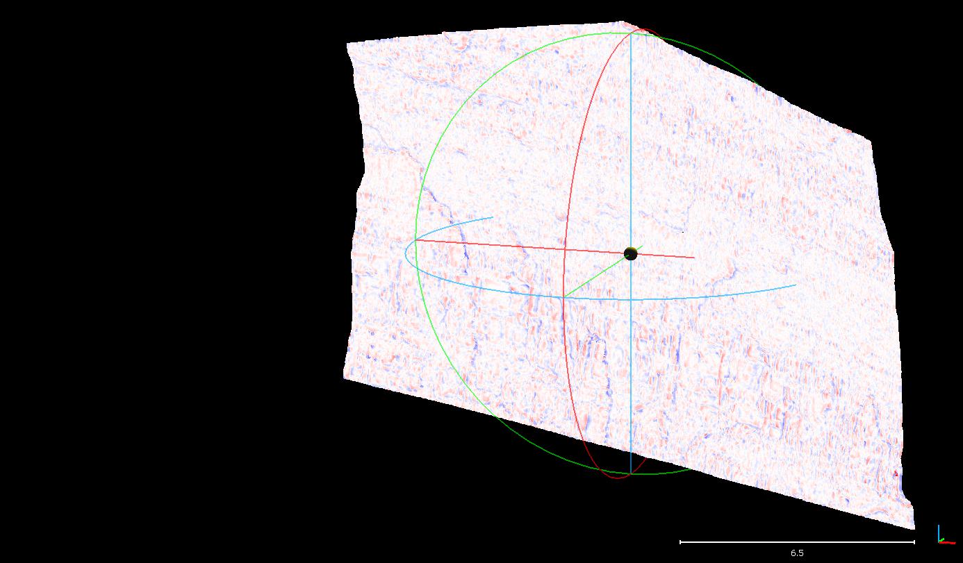

Yon can see the global orientation and the scale in the images attached below. Moreover, I've got the following parameters using the 'auto' button of M3C2: D = 0.038541 m, d = 0.077082 m, Max depth = 1.287666 m.

Ok, then the preferred orientation for normals seems good. However it may give locally wrong orientations on the most 'bumpy' areas. You can compute the normals beforehand with 'Edit > Normals > Compute'. This way you'll be sure that they are ok (don't forget to check the 'use cloud #1 normal' option in M3C2 then). And looking at your cloud and at the values returned by the 'Auto' button, I wouldn't use a radius greater than 5 or 10 cm (i.e. 0.05 or 0.1).
Then for the projection, I would use also 0.05 or 0.1 at most (just as you found yourself). And for the max depth, 1 or 1.5 m seems more than enough.
Can you update me with the results?
