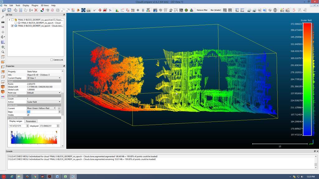

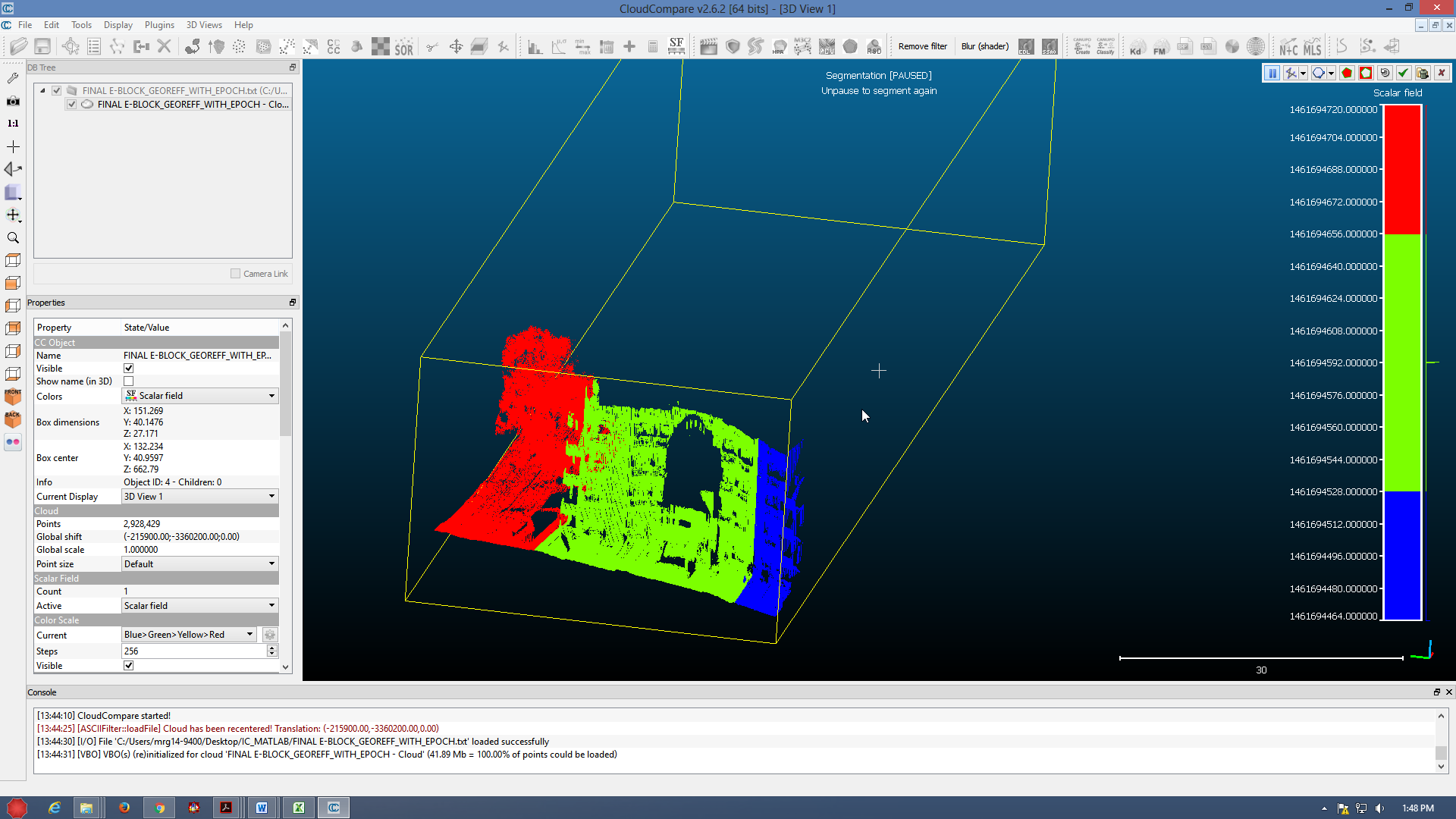

I am Inder Chauhan, I have a point cloud whose scaling value is so high "it is time in epoch seconds like: 1461694500.000030800", there are so many values with a small separation after 5th decimal place. So cloud compare is clubing the major values and showing lower scale. screenshot attached: 1-Result coming, 2-screenshot expected

Just use a newer version and the Global Shift mechanism will trigger (on the coordinates only).

Thanks for assisting, but I am already using Latest version of cloud compare i.e ver 2.6.2 64bit.
Re: Scaling Parameters
The latest is the 2.7.0 ;)
And if your issue is with a scalar field, then you'll have to shift it yourself before importing it in CC.
