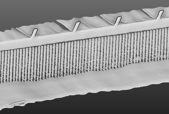

I have a multibeam bathymetry dataset (x,y,z) of a quay wall. The dataset is quite dense and the quay wall consist of piles. the aim is to find irregularities in the quay wall. As the wall is almost vertical it would be nice to be able to draw a plane through it to calculate the distances in front and behind the plane. Or to be able to colorize referred to this plane and not to the standard x, y, z axis. Attached is an image.
Is this possible and if yes, how to do?

Plane through quay wall for colouring
- Quay wall.png (158.64 KiB) Viewed 4569 times

Quite easily:
- Segment (some of) the points belonging to the wall with the scissors tool
- Select the subset of points and fit a plane (Tools > Fit > Plane)
- Select the plane and the cloud and compute the distances (Tools > Distances > Cloud to Mesh dist.)
