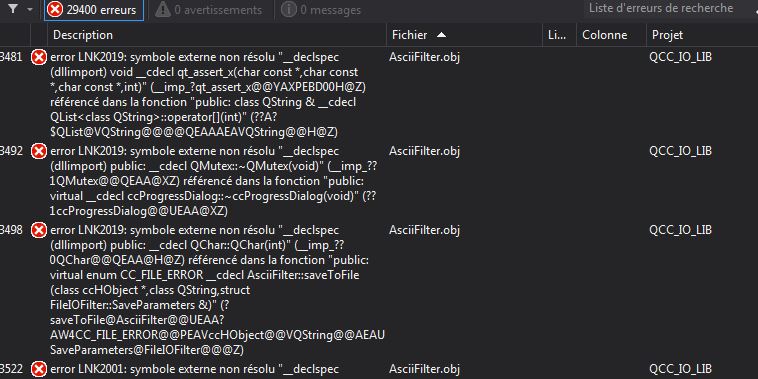

I have compiled successfully CC. But when i generate the project "CloudCompareProjects.sln". I have a lot of errors
I used Qt5.7 vs2012 and CC2.7. It's caused by their incompatibility.
Thank you in advance for your response

I changed the version of CC(2.6.3.1) and Qt(4.86) and I had fewer errors

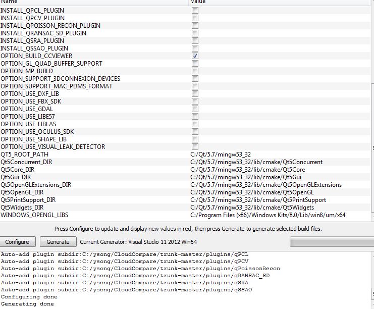

Re: Problem for compiling CloudCompare
In the first case: you were not linking with Qt for Windows 2012 but for MinGW (see the QT5_ROOT_PATH ;) ). I'm not even sure Qt provides Qt 5.7 for MSVC 2012 anyway... Moreover CC 2.7 requires a C++x11 compatible compiler (i.e. MSVC 2013 or newer).

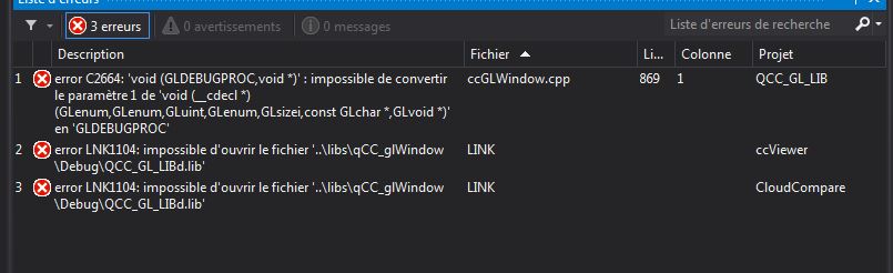

1>------ Début de la génération : Projet : QCC_GL_LIB, Configuration : Debug Win32 ------
1> ccGLWindow.cpp
1>C:\ysong\CloudCompare\trunk-2.6.3.1\libs\qCC_glWindow\ccGLWindow.cpp(869): error C2664: 'void (GLDEBUGPROC,void *)' : impossible de convertir le paramètre 1 de 'void (__cdecl *)(GLenum,GLenum,GLuint,GLenum,GLsizei,const GLchar *,GLvoid *)' en 'GLDEBUGPROC'
1> Cette conversion requiert reinterpret_cast, un cast de style C ou un cast de style fonction
2>------ Début de la génération : Projet : CloudCompare, Configuration : Debug Win32 ------
3>------ Début de la génération : Projet : ccViewer, Configuration : Debug Win32 ------
3>LINK : fatal error LNK1104: impossible d'ouvrir le fichier '..\libs\qCC_glWindow\Debug\QCC_GL_LIBd.lib'
2>LINK : fatal error LNK1104: impossible d'ouvrir le fichier '..\libs\qCC_glWindow\Debug\QCC_GL_LIBd.lib'
========== Génération : 0 a réussi, 3 a échoué, 9 mis à jour, 0 a été ignoré ==========
It's this that you want? Thank you so much
Oh, it's for the GL_KHR_debug extension, it's not important at all.
You can comment the whole section:
if (ccFBOUtils::CheckExtension("GL_KHR_debug"))
