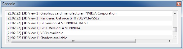

With updating to 2.7 we removed any previous versions. Opening CC 2.7 being logged directly onto the computer we have the following OpenGL and graphic card manufacturer:

Ok, CloudCompare 2.7 requires OpenGL version 2.1 at least.
I wonder if remote desktop can 'emulate' OpenGL 2.1 instead of 1.1?
