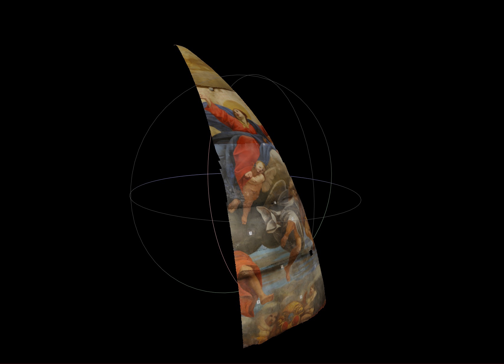

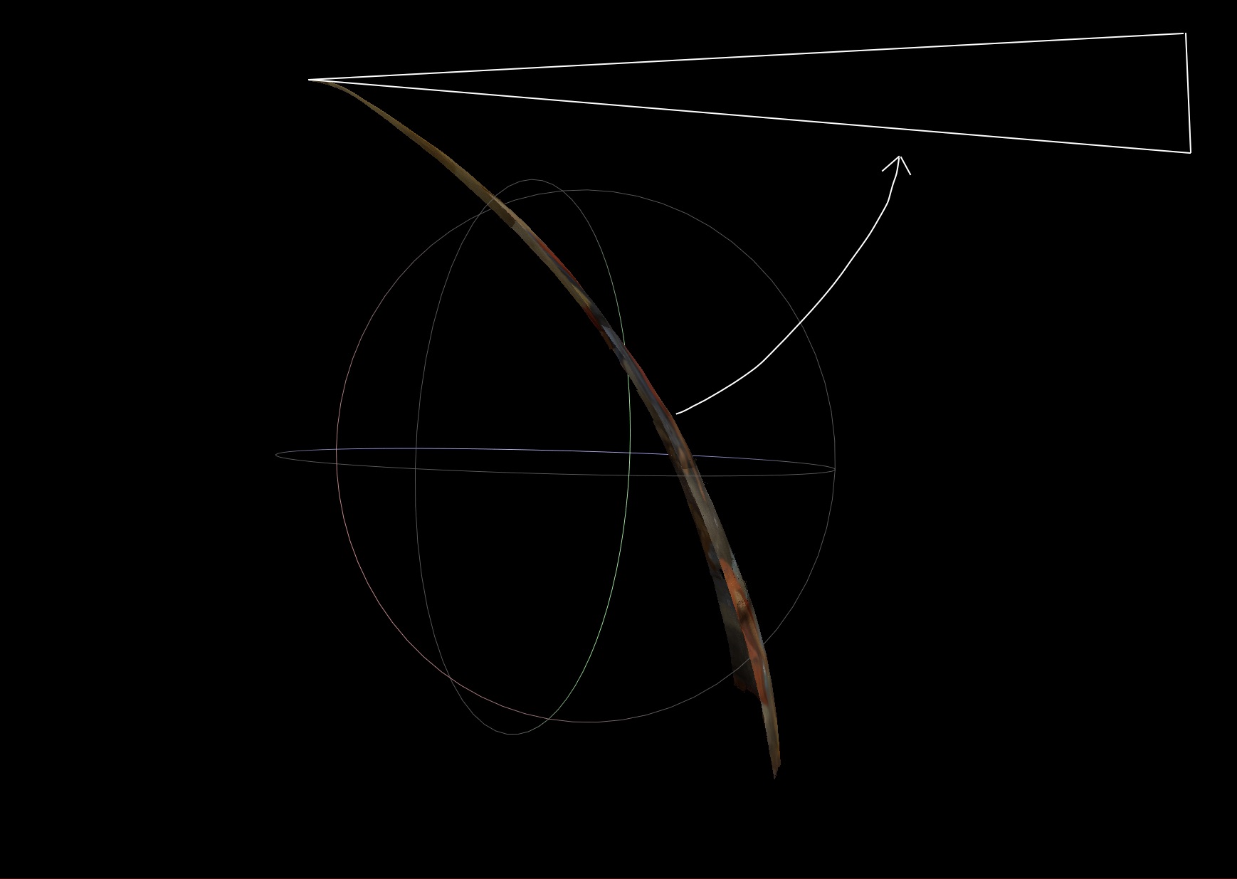

I have this part of a big model. On the mesh there is a textures. So, I need to elaborate a flat drawing for a restorer. Is it possible with cloud compare?
Yes, I know that it is a model with two direction of distortion and so will be distorted, but is there other solution?
Thank you
unroll Mesh with texture

Sadly it's not possible to do this kind of 'spherical' retro-projection with CloudCompare directly.
With CC you could:
And eventually you could load the projected cloud back to CC to generate a visual.
With CC you could:
- sample a lot of points on the textured mesh to get a dense point cloud (with colors)
- fit a sphere to determine the center and radius of the dome
- export the cloud as an ASCII file
