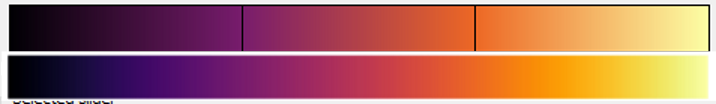

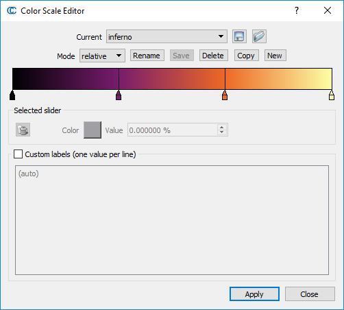

Last change, I swear. This modified version solved daniel's concerns. You can now select the number of segments you want to use. For instance, using 4 segments as below gets a near-perfect approximation of inferno. You can adjust more/less segments as needed for balance between performance/perfection.
This script will take any matplotlib colormap and output the xml
for a CloudCompare 256 color scale. Here's a list of Matplotlib maps:
https://matplotlib.org/examples/color/colormaps_reference.html
from matplotlib import cm
from math import trunc
import uuid
# Change the name in quotes to your desired colormap:
colormap = 'inferno'
# Change the value below to set how many segments to use. This should be a value from 2 to 256:
segments = 4
cmap = cm.get_cmap(colormap)
segment = 1 / (segments - 1)
print('<?xml version="1.0" encoding="UTF-8"?>')
print('<CloudCompare>')
print('    <ColorScale version="1">')
print('        <Properties>')
print('            <name>' + colormap + '</name>')
print('            <uuid>{' + str(uuid.uuid4()) + '}</uuid>')
print('            <absolute>0</absolute>')
print('        </Properties>')
print('        <Data>')
for x in range(0, segments):
    rgba = cmap(x * segment)
    r = str(trunc(rgba[0] * 255))
    g = str(trunc(rgba[1] * 255))
    b = str(trunc(rgba[2] * 255))
    print('            <step r="' + r + '" g="' + g + '" b="' + b + '" pos="' + str(x * segment) + '"/>')
print('        </Data>')
print('    </ColorScale>')
print('</CloudCompare>')
This results in:
<CloudCompare>
        <Properties>
            <name>inferno</name>
            <uuid>{3d3ffad0-0ef3-4c06-b57b-0bff7d3177bd}</uuid>
        </Properties>
        <Data>
            <step r="0" g="0" b="3" pos="0.0"/>
            <step r="120" g="28" b="109" pos="0.3333333333333333"/>
            <step r="237" g="104" b="37" pos="0.6666666666666666"/>
            <step r="252" g="254" b="164" pos="1.0"/>
        </Data>
    </ColorScale>
</CloudCompare>
You can see the resulting color scale in the attached image:
And a comparison with the color scale on top and the original below. You can see it's close, but not perfect. Again, a few more segments would drastically improve the appearance:
