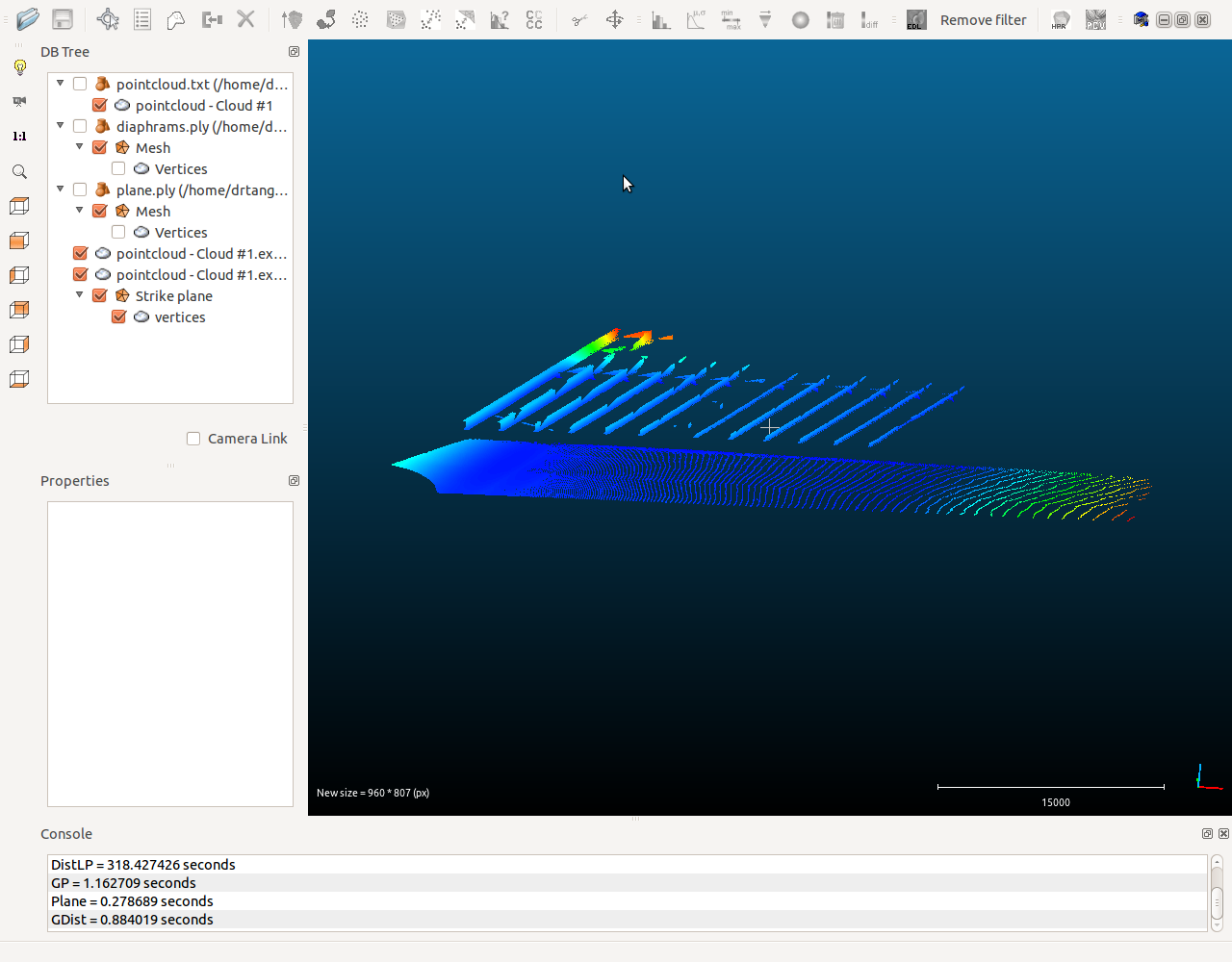

I had been reading the forum and came to know that the CLOUDCLOUD_DIST fits the local plane to get the distances using the nearest neighbor approach. I am assuming in my case this would result in the vertical distances only ?
I have attached a screen shots of my processed data, if you look at it, there are two point clouds (one for the bridge girders and the second one for the sub structure).
Screenshot attached
Screenshot attached
For the sub structure on the sides you can see that distances are more (scalar fields greens and red) as when compared to the cloud directly below the sub structure, so is this calculating the shortest distance ?

The Cloud/Cloud distance with a local (plane) model takes a very small amount of neighbors in order to be fast. I believe it's 6 for the moment but it may even be less. But we should definitely add a parameter in the GUI as this is rather sensitive. However this approach is very sensible to noise and its interest is only to reduce sampling influence on the global result (locally the results can be quite strange sometimes as the nearest neighbors can be far or very noisy).
