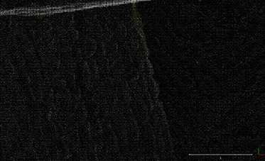

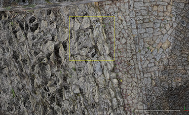

I have this huge point cloud that weighs 3.5gb and is already rotated so to be parallel to the "set front view". The intent is to make a screenshot ("render to file") in order to have a sectioncut/elevation of the building. But when exporting the image (no matter what the "point size" or "zoom" is) it does not display every point of the point cloud.
To better explain here are some images:
A)screenshot to show the density of the point cloud . Note that point size is set to 5.
B)render to file of the point cloud. Here, the point cloud has been segmented. The part that is more dense is the small segment. The rest of the point cloud, which is more sparse, is part of the bigger point cloud. In other words, I found that as the point cloud size increases the fewer points are taken into account for making the final image. Inversely, the smaller the point cloud the more points are represented.
Is it due to hardware? Or is it something that I am not doing right?

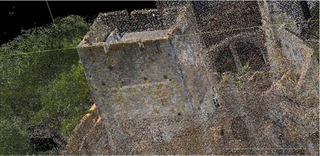

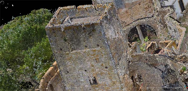

opened a a 1gb point cloud + 0.6gb point cloud together. Took a screenshot of an area and everything was sparse (C). I made a really tiny slice and when a new render was processed surprisingly everything was normal (D) (I was expecting only the really tiny and small segment to be with normal density as shown in screenshot#2 in post #1).
For these I chose 'zoom' 10, unchecked 'don't scale', checked 'render overlay items', 'point size' default.
