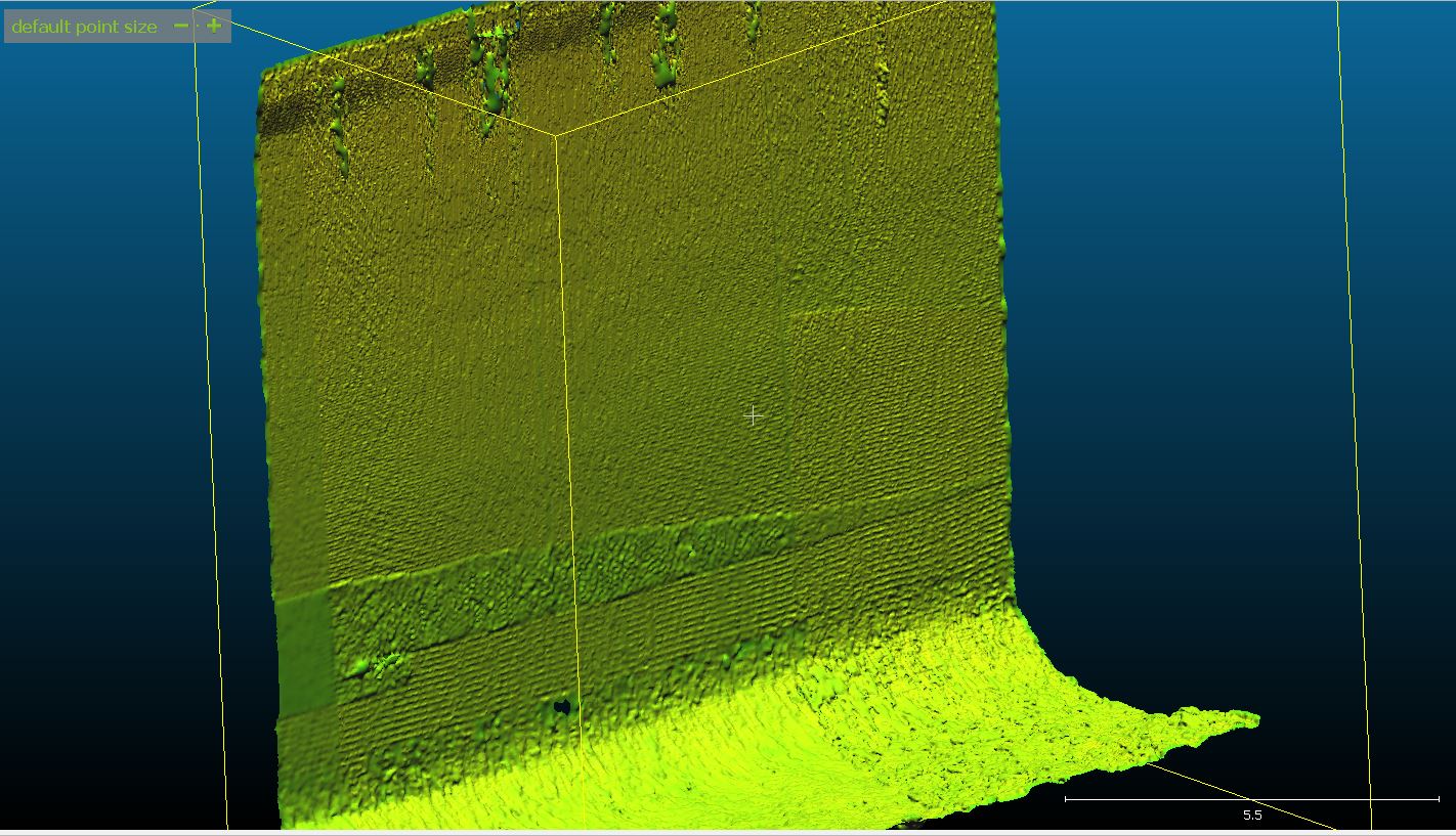

What do guys think of this Poisson surface of an underwater Quay wall?
You can see the effect of different passes with the sonar yield slightly different positioning of the data points, this is due to a combination of small errors within the: GPS positioning, Motion sensor correction, differing water density etc.. and it makes the Poisson surface look messy/inaccurate.
My question is this, can these different sets of data be aligned within Cloudcompare? or should I just choose a lower density surface construction?
Cheers, any help would be much appreciated!
Re: Underwater Sonar data
Posted: Fri Mar 25, 2016 11:00 am
How many different sets have you? If it's 2 or 3 then you should indeed be able to improve their relative registration (if the overlap and density is sufficient of course).
Otherwise, level 15 for Poisson is huge (you can reduce this a lot - e.g. 10 or 11 - without changing the output quality much). And computing smoother normals (with the Quadric mode and a large radius) can help in your case, but only a little.
And to smooth the result you can indeed reduce the Poisson depth, but you can also use the 'Edit > Mesh > Smooth' algorithm.

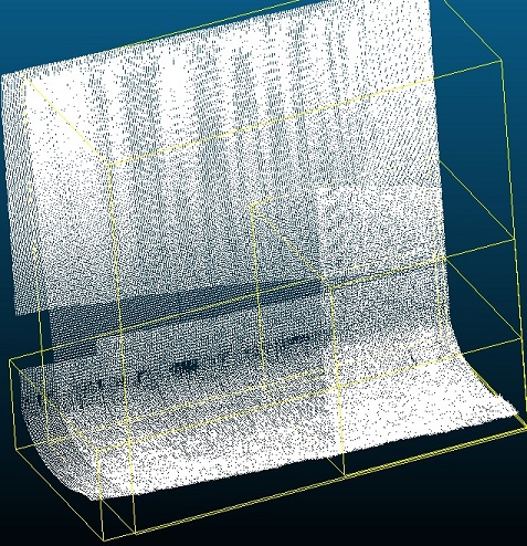

Yes, should I send you the data or just take a screenshot of each cloud?
Posted: Fri Mar 25, 2016 1:13 pm
by multibeam
Heres a quick screenshot anyway:
Each set.JPG (163.44 KiB) Viewed 4853 times
Posted: Fri Mar 25, 2016 3:21 pm
You can send me the data at 'cloudcompare [at] danielgm.net'
It's always a bit dangerous to register very flat clouds this way... I'll see if it's possible.
