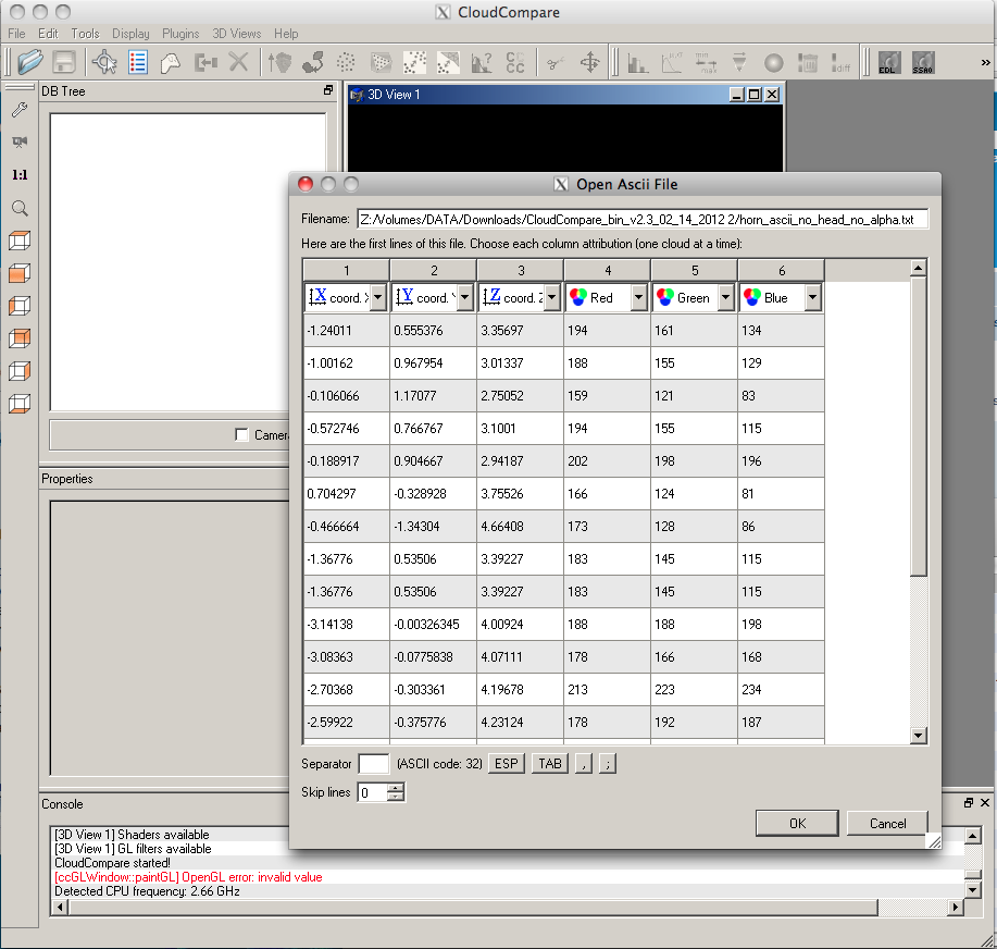

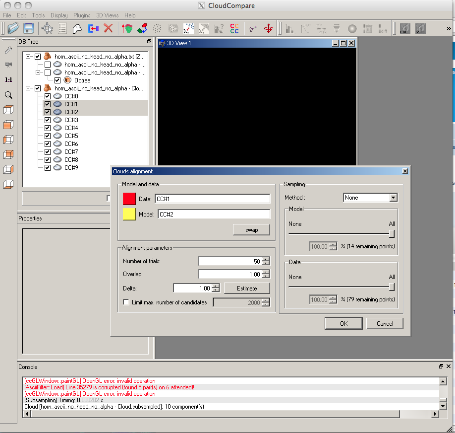

Rather than a 'pipe dream' request, I thought I would post my own attempts to get CC working on a mac ..
Actually, it's fully functional ... but blind. The openGL driver does not run ..
See attached screenshots .. as long as processing can be done a) by memory and b) through selection in the left menu
.. then it's all good! :)
Not sure if this is a difficult or a simple fix .. perhaps a different wine engine would have a compatible driver?
Running WineSkin here.
Thanks!
Screen shot 2012-03-20 at 11.29.34 AM.png (75.25 KiB) Viewed 20044 times
Screen shot 2012-03-20 at 11.27.57 AM.png (74.84 KiB) Viewed 20044 times

Isn't it like sharing screen on Windows?
On Windows, you must disable 3D acceleration (there's a specific option for this in the 'display' options) in order to be able to 'grab' OpenGL contexts. Otherwise, OpenGL rendering is done in 'overlay' mode (i.e. rendering output is sent directly from the GPU memory to the screen - thus bypassing Windows - in order to draw much faster). In this mode, there's no way for Windows or any other software to access to displayed data. If you disable hardware acceleration, display is much slower but you can freely access to it (with the 'Print Screen' key by instance).
I guess something equivalent is at work here. However I can't help you much as my knowledge of OS X is almost zero...
