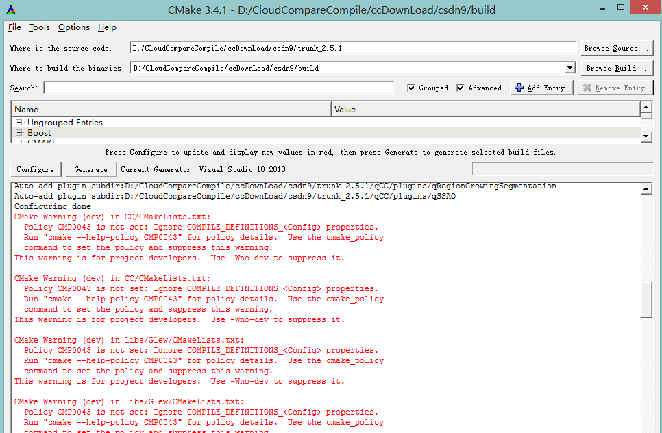

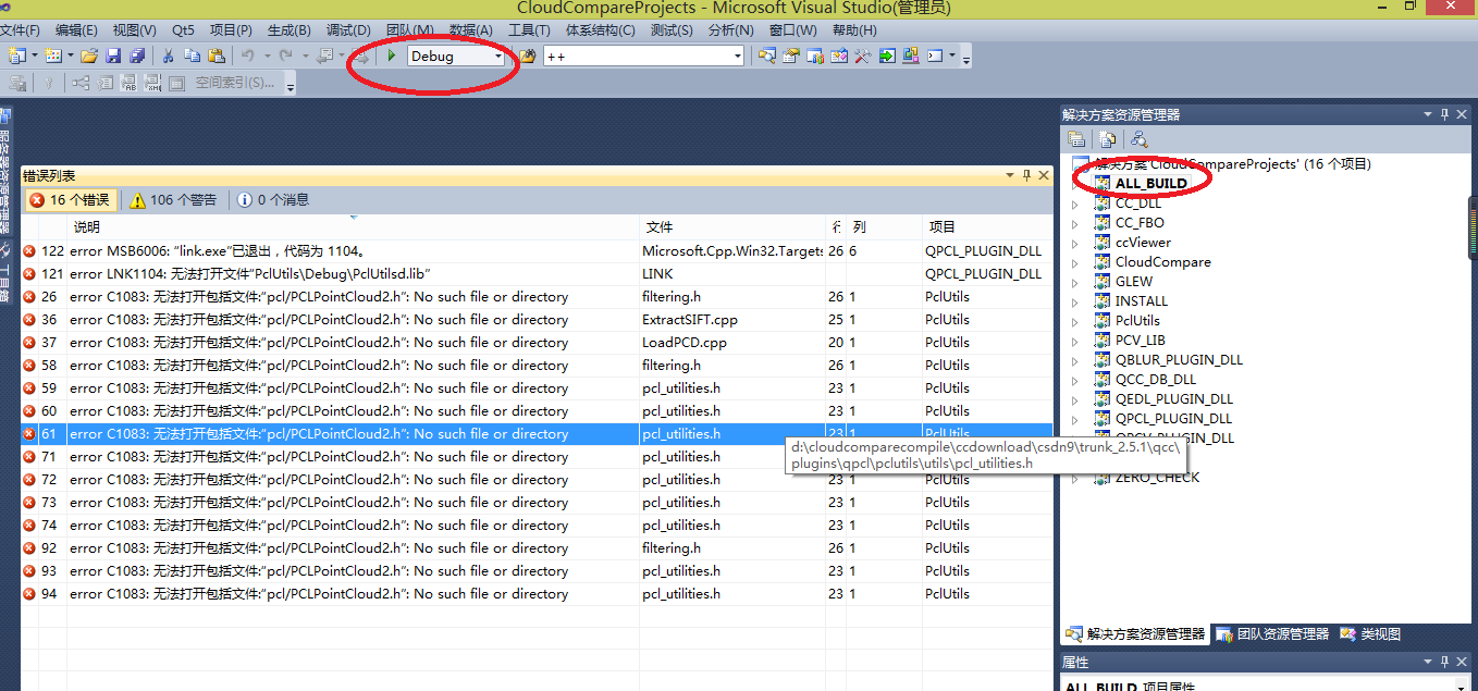

when compiled trunck2.5.1 version,I tried to add plugin.
there are some warnings,Eventually MSVC2010 has the following error in the console.How could I debug that?

To debug CC with Visual:
- compile the 'INSTALL' project (always)
- but set the 'CloudCompare' project as active (right click on it and find the right option)
- the first time you also have to change the 'Command' target in the 'Debugging' section of the project properties (see http://blogs.microsoft.co.il/meravk/wp- ... 8/Pic3.png for instance). Instead of the default command, you have to point to the installed version of CloudCompare.exe (i.e. the one that is generated by the INSTALL project)

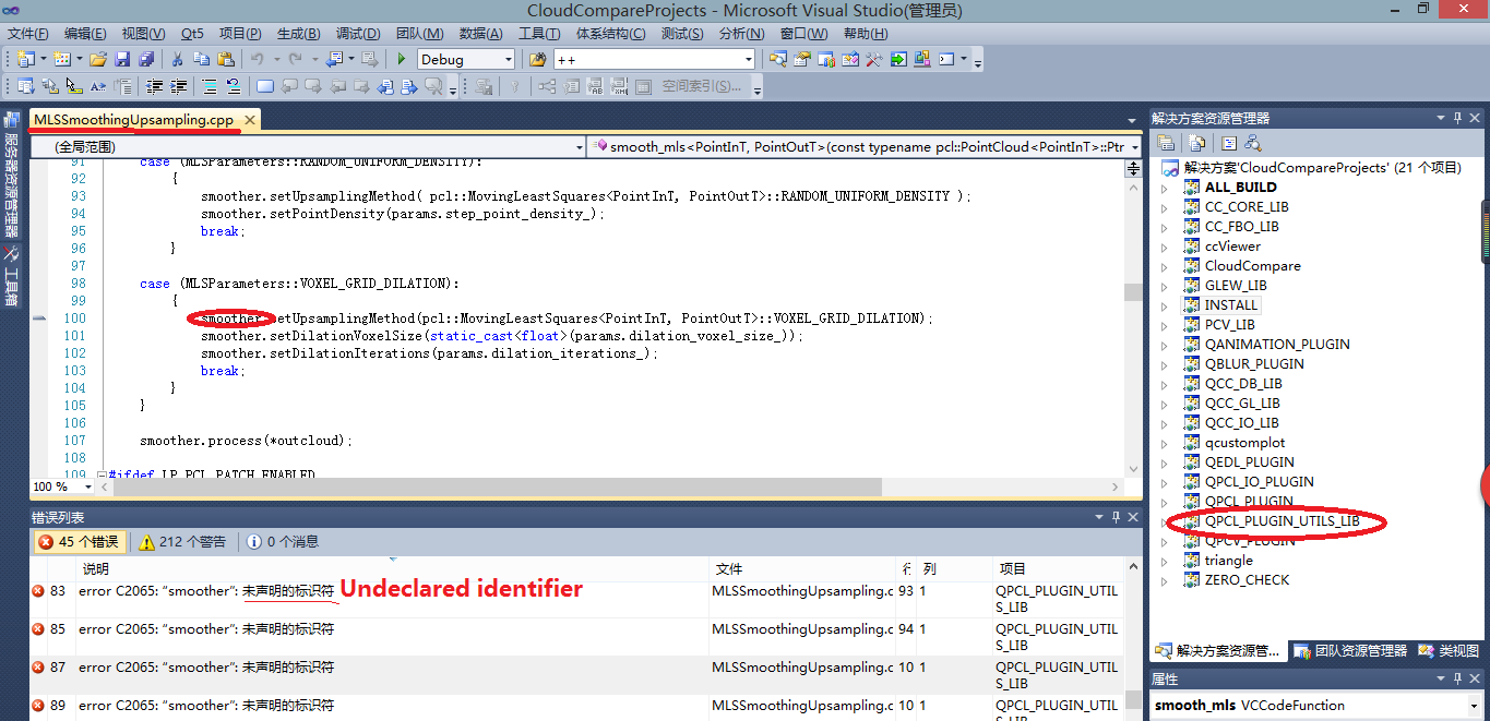

I try to add qanimation_plugin,qblur_blugin,qpcv_plugin,qedl_plugin, These are all successful.but when add qpcl_plugin,I can see in the console the following message
How should I do?

I bet the class of the 'smoother' object is not recognized (you must have an error about an undeclared specifier, or something equivalent). And it probably means that you are not using the right version of PCL.
Re: where is the dll of plugin?
Hi Daniel
Thank you so much for your help,When I use PCL1.7.1 instead PCL1.6, I succeeded.
