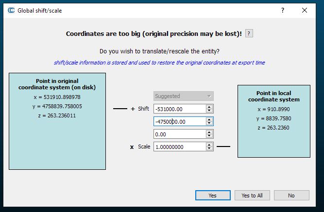

When opening a LAZ cloud, we have an opportunity to set offsets. I work in UTM so my offsets in XY are pretty big though I always set them to even 500m or 1000m values. In Z I'm usually in the 100m to 350m range, so I prefer to set the offset to 0.

Regarding the offsets, a picture is worth 1000 words. This is a typical setting for me.
Shift and Scale settings
Shift and Scale.JPG (48.14 KiB) Viewed 260371 times
EDIT: Oops! I was too quick giving you a sample. The Y value shouldn't be 8839.758 but just 839.758. I don't remove the 1000's place.
I usually set the file precision to 0.01m and do a 'remove duplicates' to the same amount before applying the scale. With these settings the data should round-trim without a problem, though by the sounds of it I should be saving and loading from you BIN format during interim steps, correct?

And indeed the Global shift parameters are ok.
