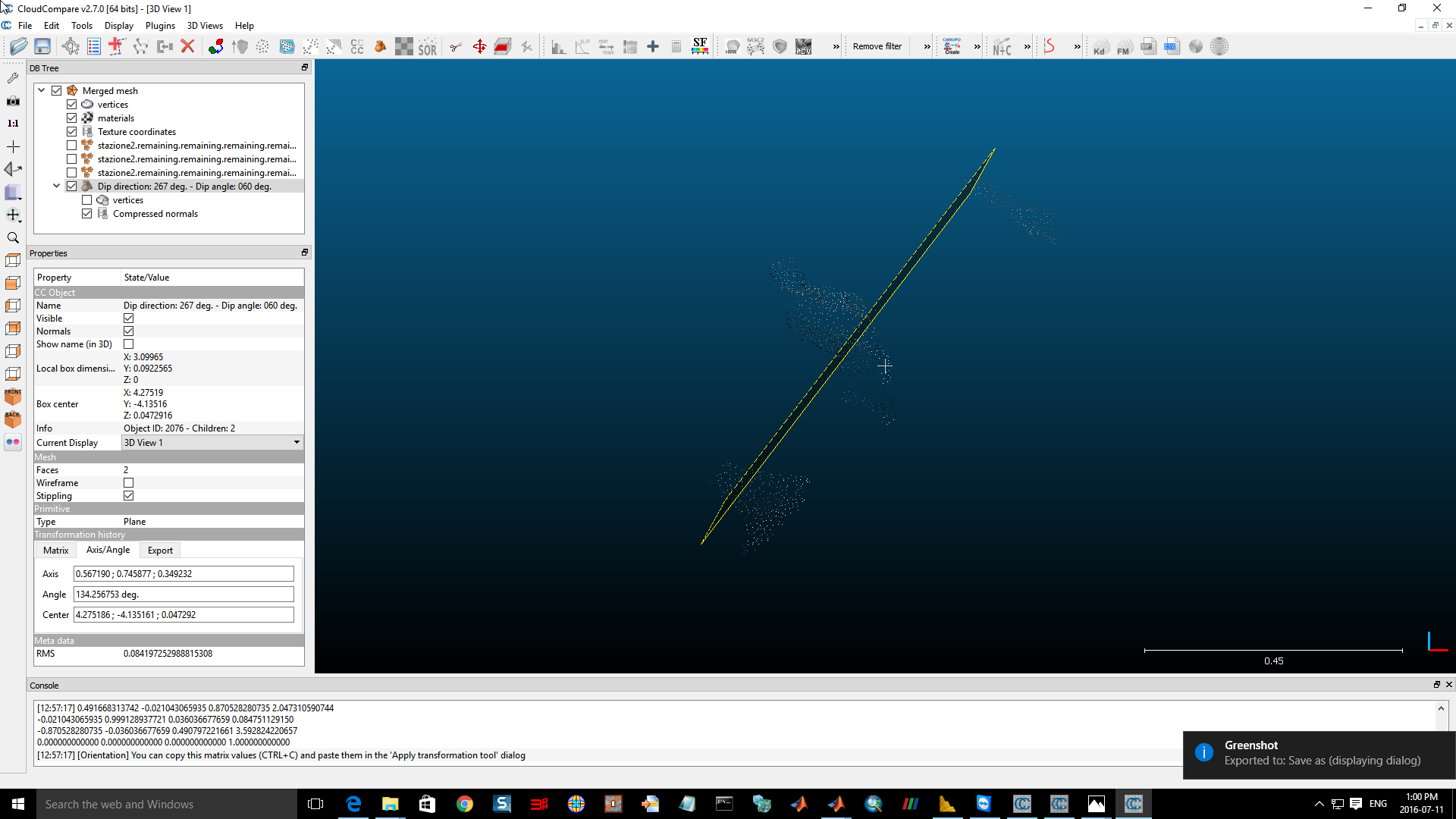

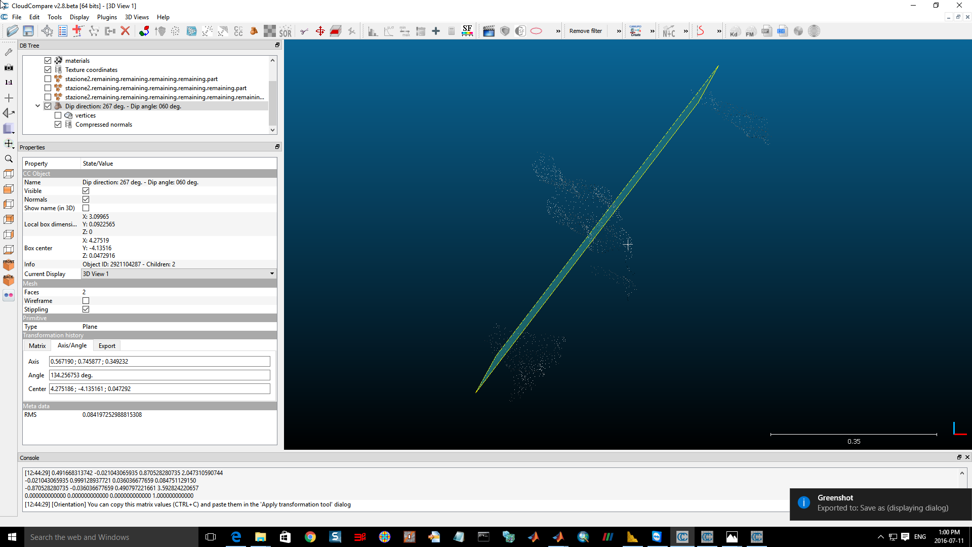

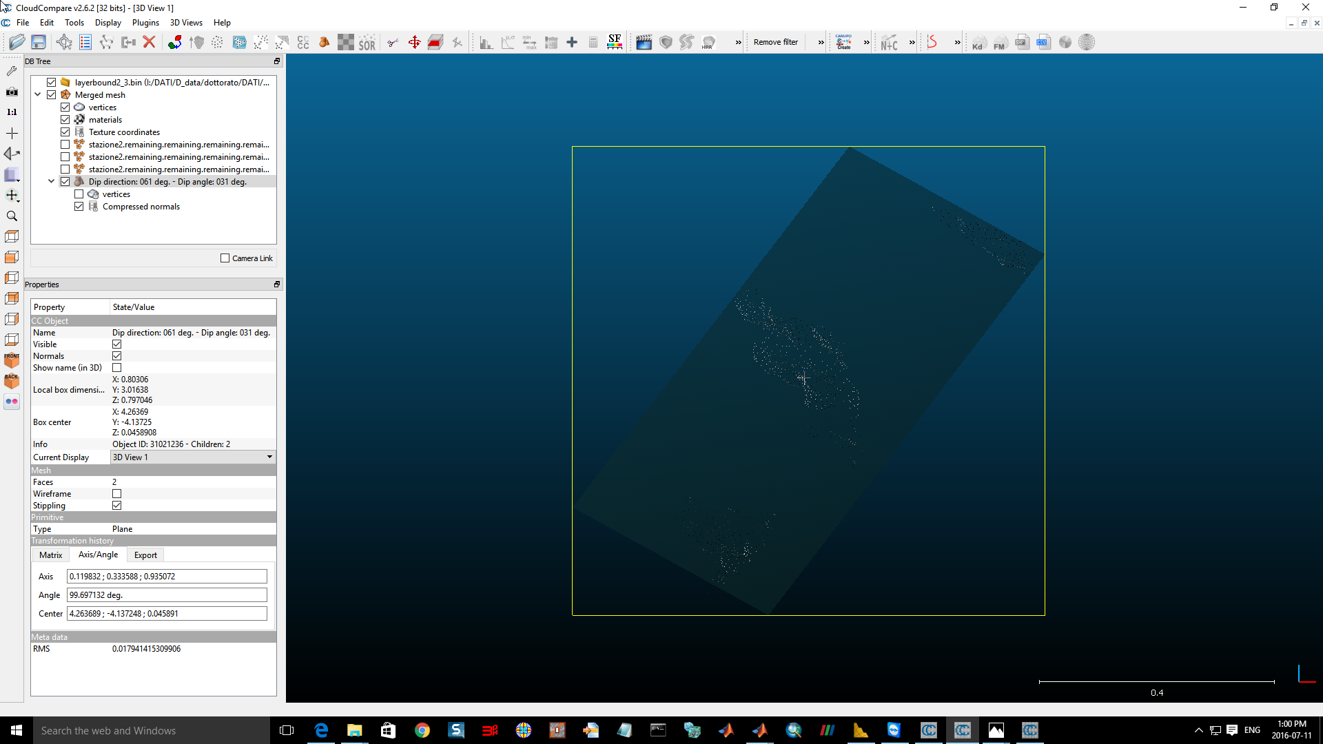

Hello Daniel,
Using versions 2.6.3, 2.7 and 2.8 I have the same problem with the Fit Plane Tool.
When I use the 2.6.2 version the plane fitted is correct, but when I used the newer versions I achieve a plane perpendicular to that fitted with the version 2.6.2.
In general this error happens when the point cloud is circa pseudo horizontal.
I attach some snapshot as example.
Thank you very much
Bye
Niccolo'
Thank you very much
Bye
Niccolo'

Re: Facet csv file: possible bug in dip direction
We have changed the plane fitting algorithm a while ago (it is in fact only an Eigen vectors/values determination). This was due to the fact that it was behaving poorly on some clouds...
We opted for the very common "Eigen" library (instead of old code inspired from the old "Numerical Recipes"). However it's possible that other degenerate cases exist for this new version of the algorithm.
Can you send me your cloud example? (cloudcompare [at] danielgm.net). Not sure that I'll find a solution but who knows ;).
