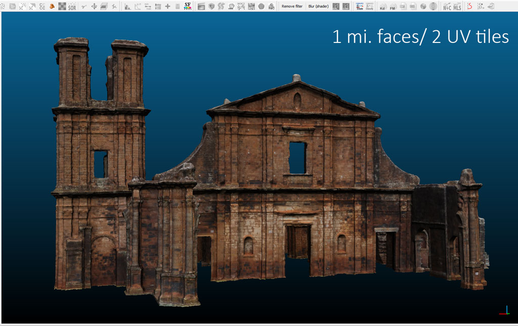

This is the result of the first model, after manipulating the viewport:

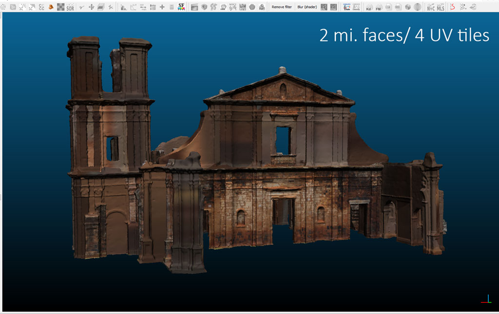

And this is what I get with the other two as soon as I do anything to the viewport:

But I found out what caused the problem...
First I created a 1M model with 8 UV tiles and it caused the same bug.
Then I took the 2M model which was showing this error and created a version with just 2 UV tiles and everything looked fine.
When I was working on the 4M model I remembered that on exporting (in Agisoft Photoscan) I had checked a option named "use UDIM texture layout".
So I went on and unchecked this option on exporting (which I only needed to take a better look on the UV's) and now all the models are working fine.
Thanks again, I hope this little incident ends up being useful for further development.
