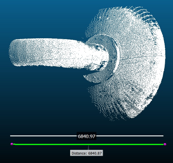

But you can use the following trick: create a fake cloud with two points having the extreme (min and max) horizontal coordinates of your real cloud.
Then with these 2 points you can:
- create a polyline (with the 'Point List Picking' tool), change it's name to the right dimension and enable the 'Show 3D name' properties of the polyline
- or create a 'Distance' label (with the Point Picking Tool). You can then collapse the label to a shorter version (by right clicking on it) with only the distance.
In both cases this will give you a kind of 2D scale bar that you can displace anywhere you want with the Translate/Rotate tool (if it's a polyline, you can displace it directly, and if it's a distance label, simply move the associated cloud).
Here's an example with both versions:
Personally I prefer the polyline version because it's cleaner and you can customize the width and change its color afterwards.
P.S.: instead of creating a fake cloud you could also simply clone your original cloud, pick the extreme points and eventually hide the cloned version at the end of the process by disabling the 'Visible' checkbox so as to keep the label visible (but it might be harder to get a nice horizontal scale).
