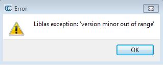

I receive this error message when dropping a las file in ( both v2.6.2b and v2.6.0):
Displayed first....
Displayed first....

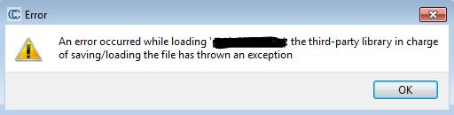

after clicking OK here, displayed this one:
Displayed after clicking OK at first
The same thing thing occurs if I compress the las file to laz with laszip.exe, the .laz file also drops this message.

Indeed, this is because Liblas (the library we use to load LAS files) doesn't support the version 1.4 of LAS/LAZ format (the one with full-waveform).
If you don't have any full waveform data, I bet lastools must have an option to downgrade the file to version 1.3?
