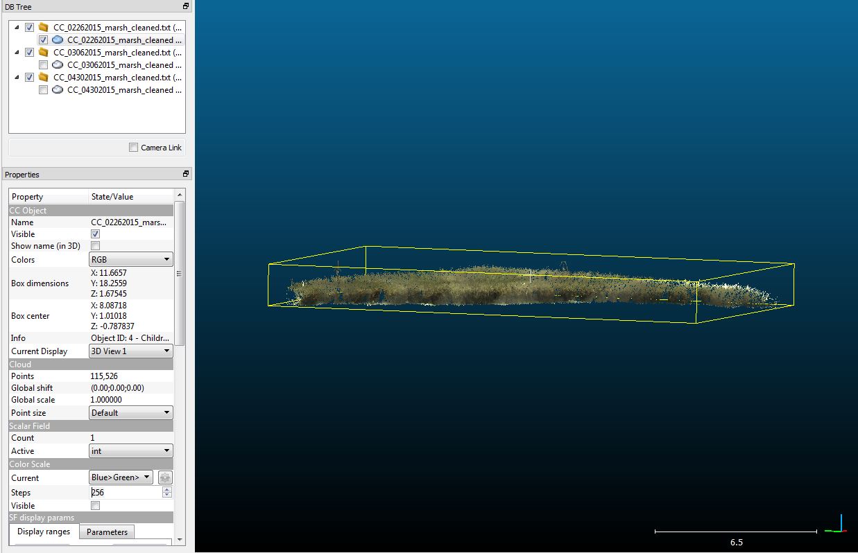

The study site is eroding horizontally (bank erosion). I am attaching a screen shot of our February scan data. I look forward to your suggestions on how to analyze the data.
Arturo Delgado
I am currently reading the scientific paper by Lague et al. to get a better understanding of how the algorithms work but its a little intense since I do not have a coding background but I am pushing through it. It does make some sense to me but I just have to absorb it some more to fully understand the material.

- screenshot_Marsh_erosion_202615.JPG (99.42 KiB) Viewed 5974 times
