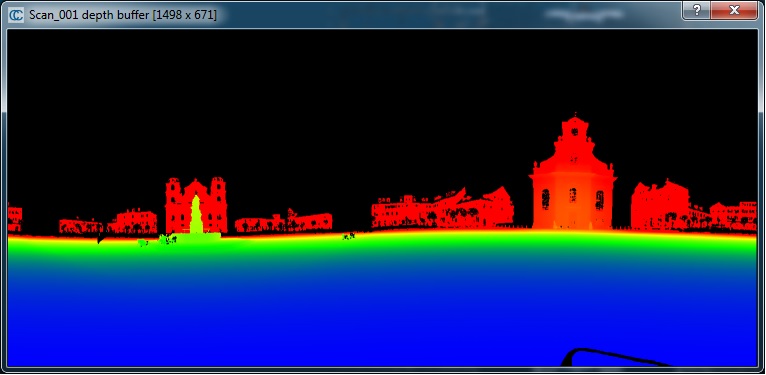

Before comparing your clouds, you'll have to do something on each 'reference' cloud:
- expand the tree under the cloud
- highlight the 'sensor' object (Ground Based Lidar Scanner)
- then go to 'Edit > Sensors > Ground-Based Laser > Show depth buffer'
You should see a depth map corresponding to what the scanner has seen during the acquisition:
Once this is done you can compute the distances. The points that are 'hidden' (i.e. farther than what the scanner has seen) or 'out of field of view' will be ignored. You will be able to hide them afterwards by unchecking the 'show NaN/out of range values in grey' checkbox in the 'Parameters' tab of the scalar field section of the (compared) cloud properties.
I'd be very interested to get some feedback on this as it's quite experimental and I don't have FARO data on my side that allow me to test this properly. If it works I'll add an option to the 'Distances computation' dialog so as to compute the depth map automatically.

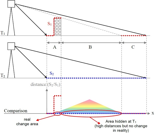

Well, this is more or less what we do with the depth map and sensor position of the reference/previous cloud.
When projecting any 3D point in the scanner point of view (and for each viewpoint if you have several scans) you can tell:
- that it is out of range (if it's very far and you know the maximum range of the scanner)
- that it was out of field of view (if it falls outside of the depth map 'rectangle')
- and more interestingly you can flag the points that fall 'behind' the depth map because you don't have any reliable information on what happened behind the disappearing wall (is it that the wall collapsed an revealed something else, or has the wall simply be shifted?). From this point you need the human intelligence ;).
And I'd be interested in before/after scans of the same area to tweak this system in CloudCompare (it was working during my PhD but the scans were not as dense as now and they were not 360°).
