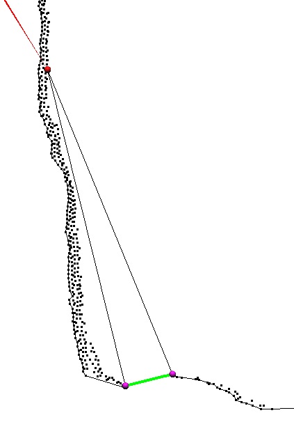

Thanks for your prompt replay. I tried to use the debug mode and i cannot say that i understood it - unfortunately. If you still can bear with me, i will try to add some screen capture to explain. So - what exactly the "max_edge_length" param does? From the little explanation i saw it supposed to make the profile contour closer to the points cloud, but making that param smaller i got some unexpected results - for me anyway.
So here it is the point cloud - already extracted along the transect - 0.5 m wide:
This is the result transect with max_edge_length = 1.9 m - the green line does not look as i expected
This is the result transect with max_edge_length = 2 m and this is the result i would have expected
And this is the combines image - as you see the lines are almost identical except in that peak the green line has.
The difference between 1.9 and 2 m is not that big - but certainly it is a big difference in the resulted transect line. If you have any idea why this is happening - please let me know. Just in case i will attach the point cloud itself as well - if you want to play with it.

First, I think that your slice is a bit too thick for the algorithm. And sadly the algorithm is also a bit too sensible to noise.
The basic idea is to start from the convex hull, and then to split the longest edge by connecting its two vertices to the nearest point in the cloud. If at least one of the new edges is smaller than the original one we continue the splitting process. Until we can't split the edges anymore or their length falls below 'min edge length'. Of course there are some more subtle tricks and heuristics but that's the basic idea.
In your case, something bad happens, probably due to these tricks and heuristics. The green edge is much smaller than the new ones but we have to do this sometimes to prevent the algorithm from being stuck (especially since the green edge is much bigger than the others).
Obviously something is wrong here. I'll try to look if we can fix this (I just don't know when I'll have the time to do this).

Finally I've added a 'multipass' option (disabled by default) to both section extraction algorithms. This way the second pass (that creates the long edges) can be avoided and it will fix your issue.
This second pass is only necessary when the profile is 'stuck' (this only occurs with highly concave profiles).
You can use the same link as previously (I've overwritten the former archive).

I just tried your new beta version and it works very nicely. I didn't realized my point cloud slices are considered "thick" since i choose 0.5 m for that param. I was afraid to make them thinner since my point cloud density is not constant over the survey. Besides, this is my first time working with these type of lidar data and i was not sure what to expect. I will try a thinner slice as well. And i have portions of the survey over concave cliffs - actually that was the point of the survey in the first place since we cannot capture that covexity / concavity of the cliff faces with the usual aerial lidar surveys.
