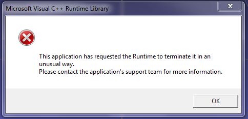

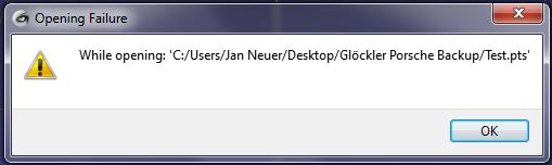

I've merged the frames, removed the normals and saved as an ASCII file with the second order scheme, but unfortunately I still get the Error message when I try to open the file... I've just played around a little bit and found out that at least I can save it as a .txt file - this can be opened and doesn't cause an Error right at the beginning. But after the import-dialogue it takes some time, and after that it also shows an different Error dialogue (see attachment). Do you have an idea what could be my failure?
many thanks for your quick help!
- Error Message while opening txt file.JPG (25.43 KiB) Viewed 18985 times
- Error Message while opening pts file.JPG (19.92 KiB) Viewed 18985 times

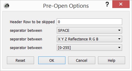

To open your file in Meshlab... you just need to use the 'txt' extension instead ;).
In this case you'll get the following dialog: To load a PTS file, use the 'SPACE' separator, and the 'X Y Z Reflectance R G B' configuration (you might spot that they used 3 times the same field names - luckily their respective roles are pretty obvious each time ;).
